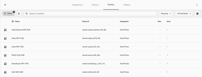

First off want to say thank you for this custom integration was something I have been looking to find for ages! I have installed it and appear to have configured it correctly as it manages to find the 6 stations within my radius that I wanted, however where do I actually view the prices and how can I have them display on a dashboard?
Sorry I am pretty crap at these things so may need explaining like I’m a 5 year old!
There is some history in this thread going back around displaying the data (I knocked this up quickly a while ago but requires some extra UI components installed) Fuel/Gas Prices integration - #14 by 11harveyj
I also came across this article a while ago too
https://keestalkstech.com/home-assistant-track-your-favourite-fuel-stations/
