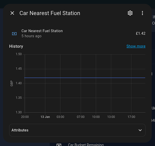

Here you go, basically this updates whenever sensor.entity_with_location moves or when home assistant starts, or when I change a input boolean to use cheapest fuels (if off it will use nearest) or finally whenever a button is pressed. This is for your configuration.yaml file under the template key.
The service call expects the location in meters (because thats how the selector works in the UI), so I’ve done 5 * 1609.34 for 5 miles.
- trigger:
    - platform: state
      entity_id:
        - sensor.entity_with_location
      attribute: longitude
    - platform: state
      entity_id:
      attribute: latitude
    - platform: homeassistant
      event: start
    - platform: state
      entity_id:
        - input_button.car_update_nearest_fuels
        - input_boolean.car_use_cheapest_station
    - service: fuel_prices.find_fuel_station
        location:
          latitude: |
            {{ state_attr('sensor.entity_with_location', 'latitude') | float }}
          longitude: |
            {{ state_attr('sensor.entity_with_location', 'longitude') | float }}
          radius: |
            {{ 5 * 1609.34 }}
      response_variable: data
    - variables:
        data: >
          {% if states('input_boolean.car_use_cheapest_station') == 'on' %}
            {{ data['items'] | sort(attribute='available_fuels.B7') }}
          {% else %}
            {{ data['items'] | sort(attribute='distance') }}
    - name: Car Nearest Fuel Station
      unique_id: Car Nearest Fuel Station
      state: |
        {{ data[0].available_fuels.B7 | float }}
      availability: |
        {{ data | count > 0 }}
      state_class: total
      device_class: monetary
      unit_of_measurement: GBP
      attributes:
          other_stations: |
            {{ data }}
          latitude: |
            {{ data[0].latitude }}
          longitude: |
            {{ data[0].longitude }}
            {{ data[0].name }}
          station: |
            {{ data[0] }}
If all goes well you should get an entity like this:
I’m only interested in diesel so have selected B7 as the state, but you can change that to whatever fuel type you like (E10, E5 etc.)
If you want multiple sensors, just add more to the bottom under the sensor key. All of the data from the service call will still be available under the data variable.

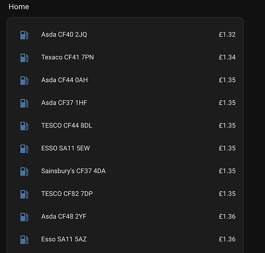

Managed to get it working and looking nice too (both with a little help from ChatGPT!!)
This can be updated by clicking/tapping the header, and returns a list of petrol stations within a 10 mile radius of whatever GPS device you’re using (my phone in this case)
Clicking/tapping on the station opens a link in Google Maps.
If anyone’s interested in how I did it, let me know!
I’ve got a docs site, I can publish your solution (crediting you of course) onto there if you like?
I’ll put it all together later. There are quite a few requirements to getting it to work!
There’s probably a more elegant solution too…

Nearby Stations
Some prerequisites:
  1. You will need the python scripts integration running.
    Add the following to your configuration.yaml if it’s not already there.
python_script:
  1. For the Lovelace card, you will need the Lovelace HTML Jinja2 Template card.
    Download here: https://github.com/PiotrMachowski/Home-Assistant-Lovelace-HTML-Jinja2-Template-card
    Or install via HACS.
Once that’s done, we need to create two input_text entities to handle the fuel station info. I split the post/zip code into a separate entity to increase the number of results before hitting the 255 character limit.
Add the following to configuration.yaml
input_text: #no need to duplicate this if it already exists!
  fuel_prices_data:
    name: Fuel Prices Data
    initial: Reloaded
    max: 255
  fuel_postcodes:
    name: Fuel Postcodes
    initial: Reloaded
    max: 255
We also need to add a template sensor to the template section of configuration.yaml.
template: #no need to duplicate this if it already exists!
  - sensor:
    - name: "Fuel Price List"
      state: >
        {% set fuel_list = states('input_text.fuel_prices_data') or 'No fuel data available' %}
        {{ fuel_list  }}
      attributes:
        formatted_list: >
          {% set fuels = states('input_text.fuel_prices_data') %}
          {% if fuels %}
            {% if fuels != 'reloading'%}
              {% set postcodes = states('input_text.fuel_postcodes') %}
              {% set fuels = fuels.split(', ') %}
              {% set postcodes = postcodes.split(',') %}
              {% for fuel in fuels %}
                {% set index = loop.index0 %}
                {% set parts = fuel.split(': ') %}
                {% set parts2 = parts[0].split(' - ') %}
                {% set fuel_name = parts2[1].replace(' ', '+') %}
                {% set postcode = postcodes[index].replace(' ', '+') %}
                {% set query = fuel_name ~ '+' ~ postcode %}
                <div class="fuelrow" style="width: 100%; display: flex; align-items: center; padding: 0px; margin-bottom: 8px;">
                  <span style="color: rgb(68, 115, 158); height: 40px; width: 40px; line-height: 40px; text-align: center;"><ha-icon icon="mdi:gas-station"></ha-icon></span>
                  <span style="margin-left: 16px;"><a href="https://www.google.com/maps/search/?api=1&query={{ query }} petrol" target="_blank" style="text-decoration: none; color: inherit;">{{ parts[0] }}</a></span><span style='margin-left: auto;'>£{{ parts[1] }}</span>
                </div>
              {% endfor %}
            {% else %}
              <div>Searching...</div>
          {% else %}
            <div>No fuel data available.</div>
Then add the following to scripts.yaml, set the fuel type and radius, and also change the device tracker to whatever device you are using.
find_fuel:
  sequence:
    - action: input_text.set_value
        entity_id: input_text.fuel_prices_data
        value: reloading
    - data:
        type: E10 #change to whatever fuel type you need
        location:
          latitude: |
            {{ state_attr('device_tracker.your_device', 'latitude') | float }}
          longitude: |
            {{ state_attr('device_tracker.your_device', 'longitude') | float }}
          radius: |
            {{ 10 * 1609.34 }}
          #change 10 to whatever radius you want in miles.
      action: fuel_prices.find_fuels
    - if:
        - condition: template
          value_template: "{{ (data.fuels | count) > 0 }}"
      then:
        - variables:
            response: |
              {{ { 'value': data.fuels } }}
        - service: python_script.set_fuel_prices
            fuels: "{{ data.fuels }}"
        - stop: ''
          response_variable: response
Last step is to save the following as set_fuel_prices.py in the python_scripts folder in your config folder.
This iterates through the results from fuel_prices.find_fuels and sends the results to the text_inputs we set up earlier.
fuels = data.get('fuels', [])
fuel_strings = [f"{fuel['distance']:.1f} mi - {fuel['brand']}: {fuel['cost']:.2f}" for fuel in fuels]
fuel_postcodes = [f"{fuel['postal_code']}" for fuel in fuels]
max_length = 255
restricted_fuel_strings = []
final_fuel_postcodes = []
length_so_far = 0
i = 0
for fuel_string in fuel_strings:
    additional_length = len(fuel_string) + (2 if restricted_fuel_strings else 0)
    if length_so_far + additional_length <= max_length:
        restricted_fuel_strings.append(fuel_string)
        final_fuel_postcodes.append(fuel_postcodes[i])
        length_so_far += additional_length
        i += 1
    else:
        break
fuel_data_str = ", ".join(restricted_fuel_strings)
fuel_postcode_str = ",".join(final_fuel_postcodes)
hass.services.call('input_text', 'set_value', {
    'entity_id': 'input_text.fuel_prices_data',
    'value': fuel_data_str
    'entity_id': 'input_text.fuel_postcodes',
    'value': fuel_postcode_str
Restart everything and head over to your dashboard.
Add the following card:
type: grid
  - type: heading
    icon: mdi:gas-station
    heading: Nearby
    heading_style: title
    tap_action:
      action: perform-action
      perform_action: script.find_fuel
      target: {}
  - type: custom:html-template-card
    content: |
      {{ state_attr('sensor.fuel_price_list', 'formatted_list') }}
And hopefully, that should do it.
Press the “Nearby” header to reload the list. Tap a result to open directions in Google Maps.
By default, results are ordered by price. I’ve not managed to figure out how to sort by distance yet, but I’m sure it’s pretty straight-forward if you know how!
I’m also sure there is room for improvement here.
We could add options to the frontend to choose fuel type and to order by distance, price, etc. That should all be pretty easy. :slight_smile:

Let’s try taking out the Google Maps link, see if that works.
Replace the template sensor in configuration with the following:
template:
  - sensor:
      state: >
        {{ fuel_list  }}
      attributes:
        formatted_list: >
          {% if fuels %}
                  <span style="margin-left: 16px;">{{ parts[0] }}</span><span style='margin-left: auto;'>£{{ parts[1] }}</span>
                </div>
              {% endfor %}
            {% else %}
          {% else %}
If that works, but you want the map link in there, we’ll figure something out. :slight_smile:
Replaced the syntax but same error result. Thanks.
Hmmmm…
Can you run the script from Developer Tools and paste the output here?
I have run ‘Scripts.find_fuel’ and get the same error message
Failed to perform the action script/find_fuel. Template output exceeded maximum size of 262144 characters
I would say the template engine is internally rendering the template into text before it’s being sent to the python script.
You might want to try lowering your radius, I know there are some providers who give us loads of attributes, and other providers who give us hardly any.
I think the contents of the HA script could probably done inside the python script though to eliminate that step entirely.
