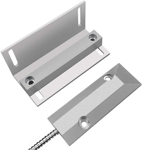

Instead of tilt sensors, I use one of these instead, I glued it to the garage floor on one side, then ran the wire to the MIMO’s contact sensor and it’s worked great for 20 years, only issue I ever had is when I knocked the bracket loose and had to re-secure it.
