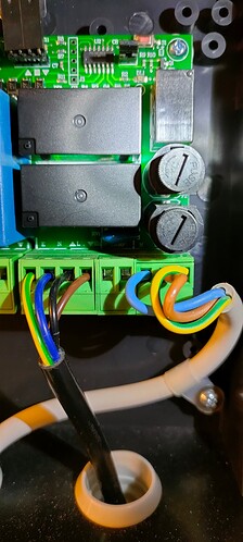

Thanks - any chance you could share your wiring diagram for using a 4CHPROR3?
Yes of course, i will take a couple of photos and post them for you. It is very simple :slight_smile:
