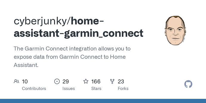

To read your workout entities go play with:
