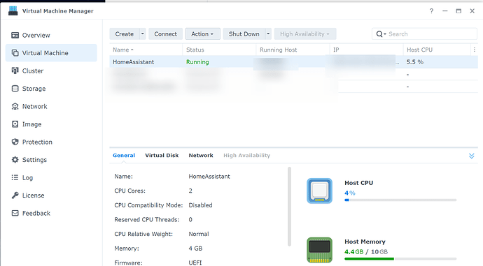

It’s not running in a docker. It’s running in a VM. So, it’s a full Home Assistant OS because I need to assign how many ram, how many CPU, allocated disk space…etc for this image to run.

  4. On the web interface of Synology, inside VM manager, edit the home assist VM, edit the VM machine, and mount the USB stick in the “other” tab.
