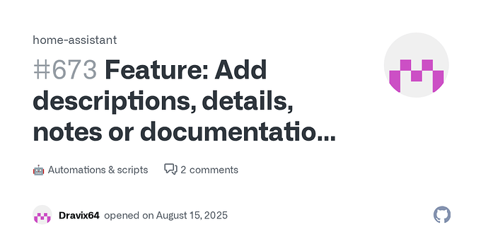

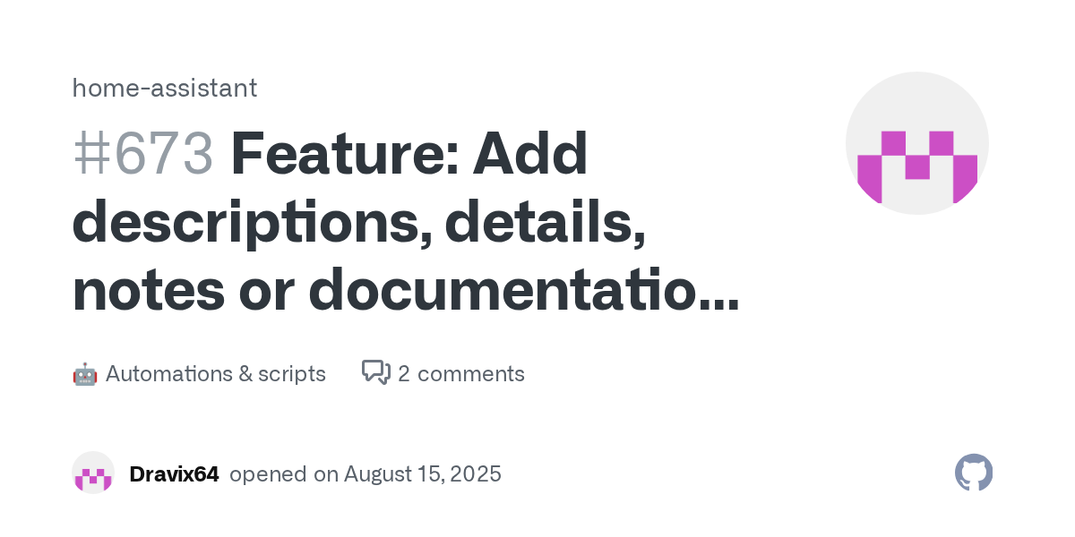

Interesting. I thought about adding a feature request, did a cursory search and found this nugget… looks like I should look into the “description” field. Per the linked comment it can be as long as necessary, use markdown and appears at the top of the GUI. Personally I was going to suggest being able to add comments in the GUI per section, maybe that appear as popups as you hover, but I’m good with this description field as well.
