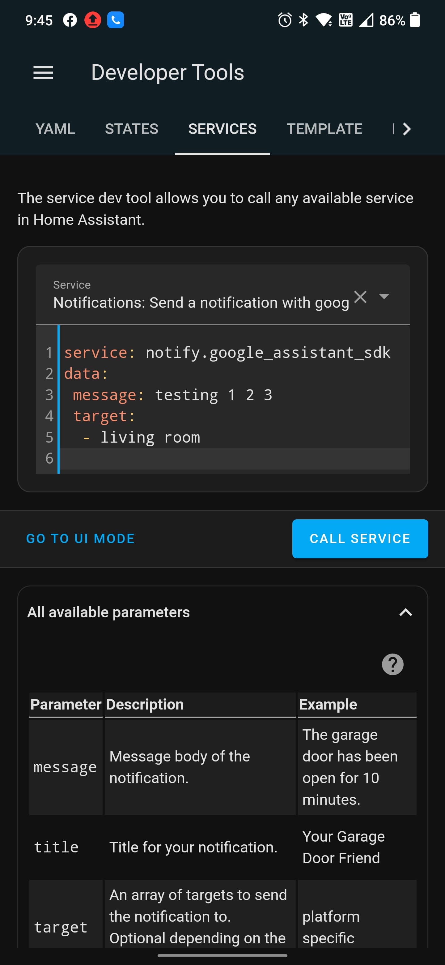

Attached to this post and screenshots of three successful attempts:
  • Broadcast all
  • Broadcast to a specific speaker
  • Send a command to my Google Home
Screenshot_2023-01-07-09-47-26-44_c3a231c25ed346e59462e84656a70e50
Screenshot_2023-01-07-09-46-15-33_c3a231c25ed346e59462e84656a70e50
Screenshot_2023-01-07-09-45-19-51_c3a231c25ed346e59462e84656a70e50

Hey Christian,
I can confirm that when the integration was functioning for me on 01/07/23, the broadcast functions were fully functioning. I tested them while playing music and with speakers idle, in both cases the speaker played a prompt sound, then said “incoming broadcast” and then read the broadcast out loud.
That all said, today (01/09/23) none of the functions of the SDK are working for me.
  • No broadcast all (notify.google_assistant_sdk)
  • No broadcast target speaker(s) (notify.google_assistant_sdk)
  • No send text commands to google home. (google_assistant_sdk.send_text_command)
Since I have not changed anything in my integration configs or Google Home setup, I suspect the issues are on the Google Server side of things.
