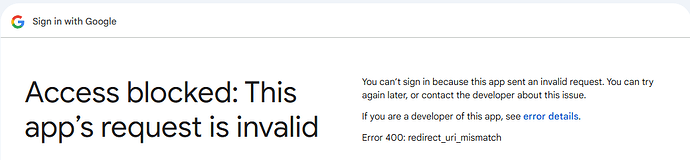

I already have credentials, but when I try to add on Google Drive, I get this:
I like that backups are getting streamlined, but if you can’t set up the integrations necessary, what’s the point?
You cannot use any existing API credentials, unless they were already setup with https://my.home-assistant.io/redirect/oauth as one of the Authorized redirect URIs in the Google Developer Console. Which is exactly what the error message says yours are not.

Still the same. What exactly am I not inputting correctly? What/where is the redirect URL?
top left hamburger menu > APIs & Services > Credentials > OAuth 2.0 Client IDs > whatever you’ve named your credentials > Authorized redirect URIs > ADD URI
Did that. Got an ID and Secret. When I try to add the integration I no longer get the option to enter them. Just goes straight to the error page.
Delete the old credentials. Settings > Devices & services > … > Application credentials.
You lost me there. Where exactly under settings are the credentials?
Exactly as written – the … menu at the top right corner.
