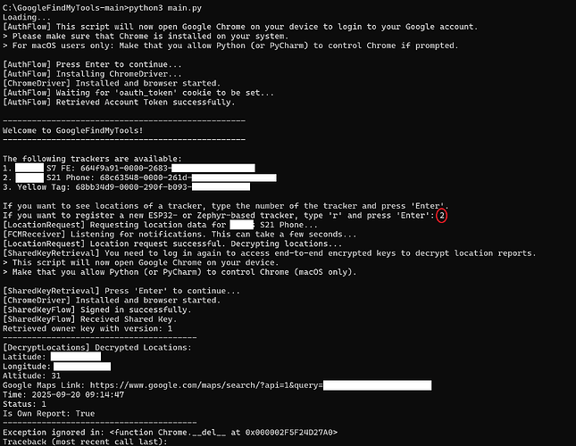

This looks to be awesome and right as I was looking for exactly something like this. However I’ve tried the GoogleFindMyTools on two different machines and still cannot get them to retrieve authentication. It keeps saying that I don’t have Chrome installed even though I have the latest version running and it’s up-to-date.
Any thoughts? It’s in Windows, btw. I run the option venv commands too, just to keep it isolated.
The only time I have seen that error is when Chrome was not up to date…I remember once I had updated but forgotten to fully restart Chrome. Also, another thing to try is putting the tools right in the C:/ drive to minimize spaces/symbols etc.
Also, just to make sure, you installed all the dependencies in requirements.txt?
Yep, all the dependencies. I’ll give it a simpler directory to minimize spaces and symbols tomorrow. My Chrome is up to date and I’ve rebooted too.
Hopefully that works out. There HAS to be a simple reason why it is not working for you. I did not use the venv commands when I authenticated…so maybe try without?
Tried with/without venv (virtual environment) - would have preferred to do it with of course, but it is what it is. Tried updating python, no dice.
Even tried on a fresh AWS Windows instance. Keeps hanging up on installing the chrome driver, saying that it can’t find it (even though it’s in the standard location, which is one of the locations in the script.)
I tried running it with Chrome not running and with it running, made sure it’s the latest version. I’m running it inside a CMD window with admin privileges too.
Three different systems, same result across all three. I’m at a loss.
Here’s the first error:
[ChromeDriver] ChromeDriver failed using path C:\Program Files\Google\Chrome\Application\chrome.exe: Message: session not created: cannot connect to chrome at 127.0.0.1:39519
Alright, I think I saw your issue post in Leon’s git…I made a few changes to the chrome_driver.py that might help…
I put it in my git here. Give this one a try instead of the one in Leon’s git
That worked! At least, it got me a lot further down the road… I got an error further down but it got me where I can at least figure it out from here.
It gets to the LocationRequest, then to SharedKeyRetrieval and to DecryptLocations… then comes up with this (after showing me the location data)
Exception ignored in: <function Chrome.__del__ at 0x000002F5F24D27A0>
Will report back shortly when I get your code working (hopefully.)
So cool, thank you!!
Side note for everyone else: this will close your Chrome browser so if you’re a crazy old fart like me and have a bazillion tabs open, just make sure you’re logged in and sync’ing your browser so you can just open them back up.
OK I reviewed the auth session stuff and it actually did work! I noticed your screenshots also had the same errors.

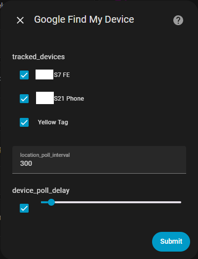

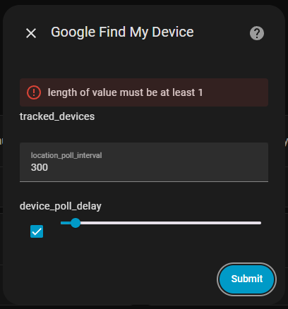

However I go to paste the contents of “secrets.json” into your app and after I hit “submit” it gives me this error:
No matter, what I set the values to (or turn off the poll_delay) it stops here…
Side note for everyone else again: It doesn’t give you a big giant box for pasting in the contents of your secrets.json file, just what appears to be a password sized box. It looks to have accepted it just fine though.
Right, it only gives a password sized box. You have to open the secrets.json in a text editor, select all, copy, then paste into the box. The integration generates the secrets.json in proper format automatically. Can you please go to the log and see if there is an error for this?

Yubikey shouldn’t matter. The error you see in the config box means that there are no devices found, which means the secrets.json might not have been copied properly or might have been missing something.
When you ran the main.py successfully, were you able to actually get coordinates from one of your trackers?
EDIT: Your use case has prompted me to do apply some better logging to the authentication process so we can see exactly what the problem is with your secrets.json. I’ll apply the update soon
Yep, I got coordinates - here’s the screenshot…
I’ll try again - I copied the entire contents of the secrets.json file and pasted right into the dialog box.
Oh! I tried again and it appears to be working!
I was able to submit and the devices showed up!! Now I just have to figure out how to USE it! LOL

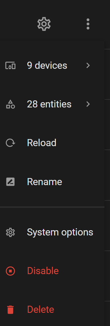

Quick question: how are tag deletions and additions in Find My Device manage in this intégration ?
I have to delete all and ask a secret json again ?
You can just remove the integration and add it again. Click the three-dot menu and click “Delete”. Then go through the integration setup steps in Home Assistant again.

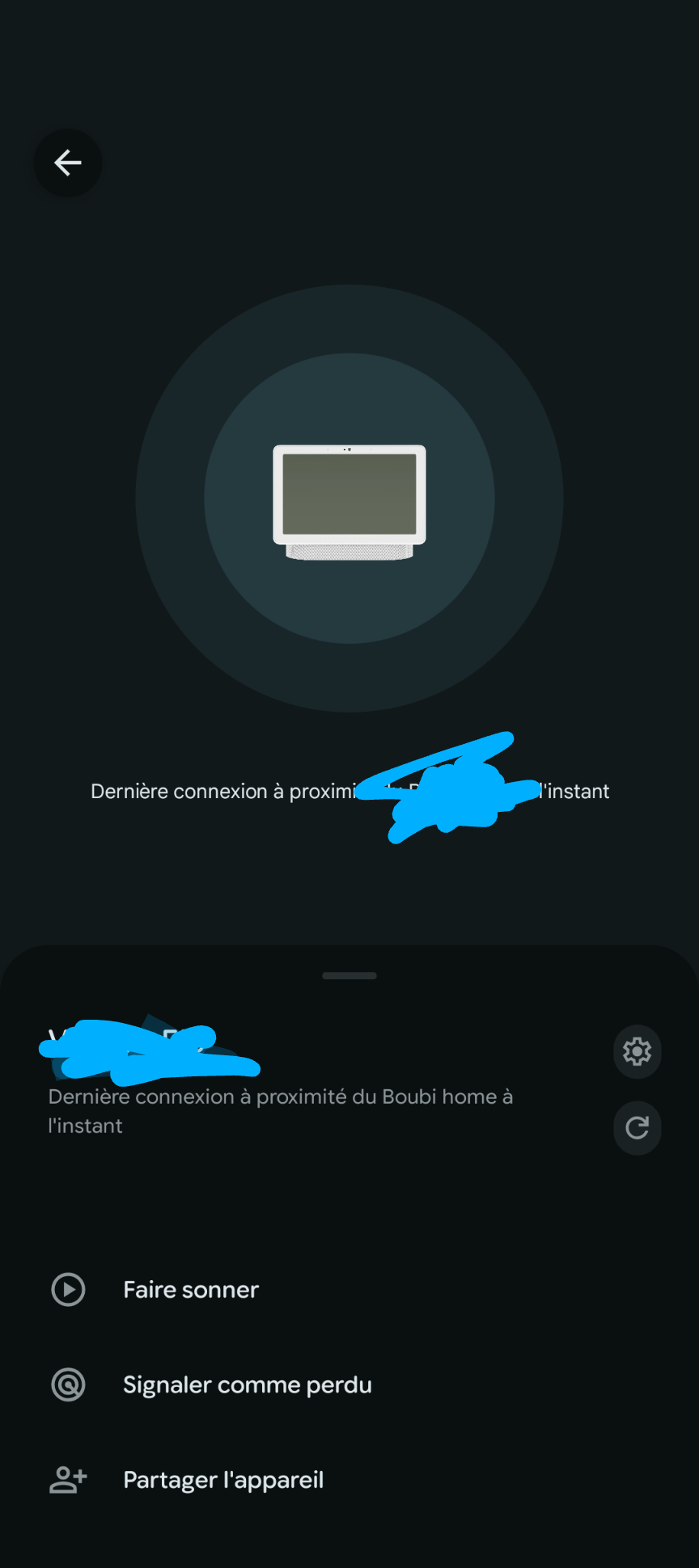

The localisation is good but I think this happens when the tags are seen by Google Home devices in the house and not by Android phones. When you see that in application screen :
With google find my tools I see the coordonates.
