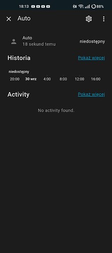

Great integration! I’m running into what seems like either a problem or a limitation, and I wanted to check which one it is.
I’ve got the trackers set up in Home Assistant—one is my phone, and the other two are similar to AirTag devices. When I use your integration to play a sound on them, it works fine. But when I try to open the tracker’s page, I get an “access denied” error. Also, if I try to add the trackers to a map in Home Assistant, they don’t show up as selectable items—even though their entities do exist.
Is this a limitation of the Find Hub integration? I saw someone mention that these types of trackers aren’t actually allowed by Google to be displayed on maps.
And as im a new user here are the trackers through the integration

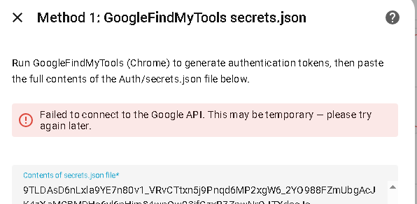

Everything went well. I also copy-pasted secret.json. But I get this error. How do I get past it?

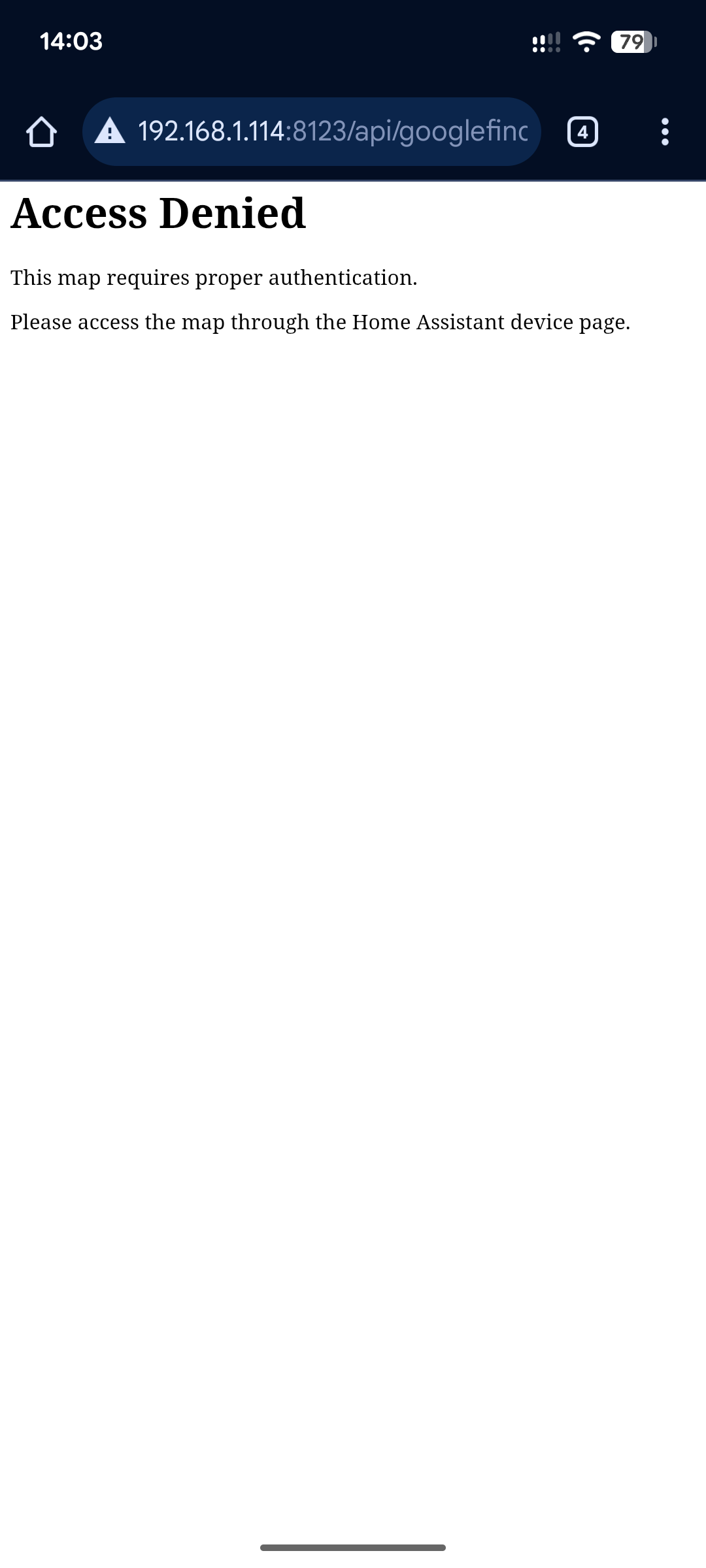

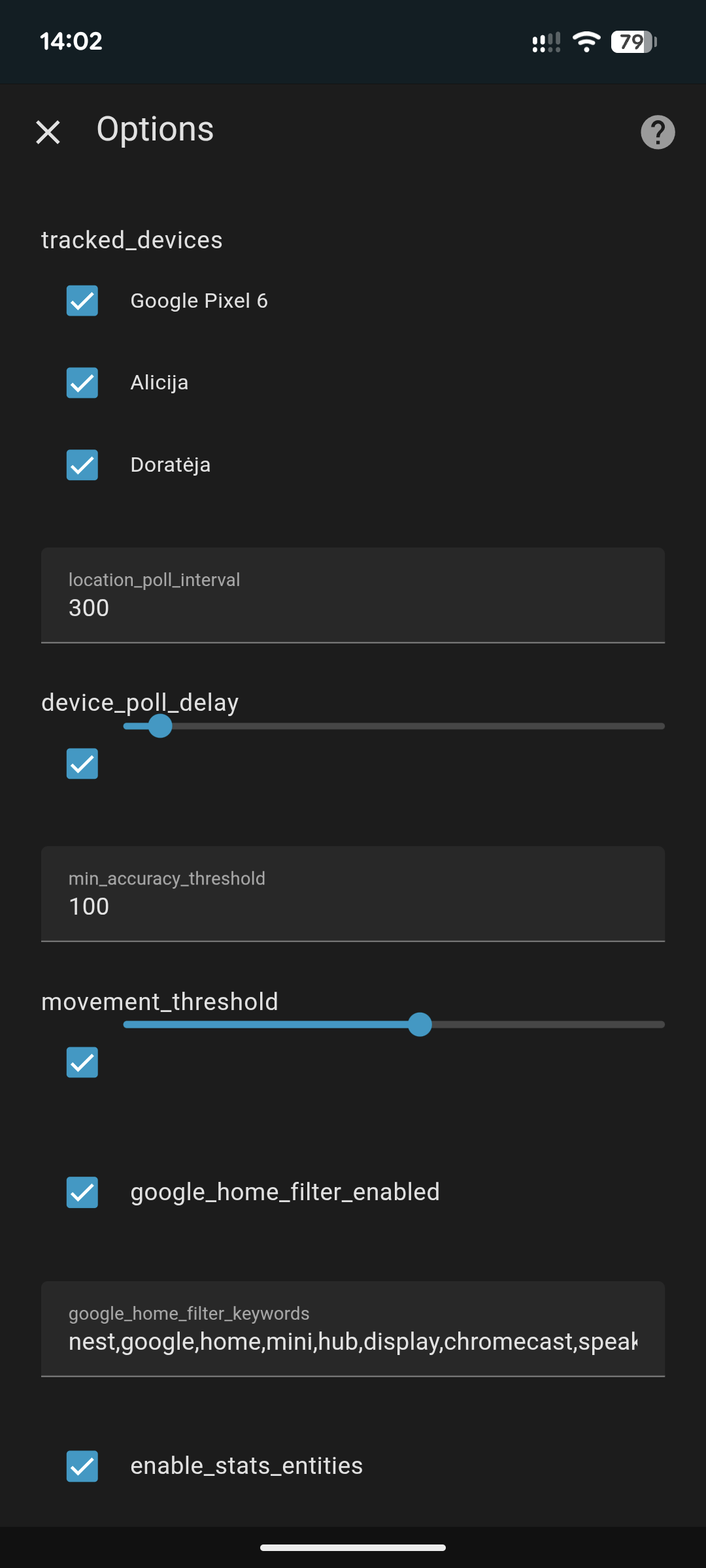

Hi, I successfully integrated Find hub integ., but the location is still not showing up. Lass seen is unknown. But when I select localization via a Python script and choose any tracker, I always get good GPS coordinates. So where is problem?
I have the exactly the same problem.
@supperka and @starmane007 is it your first time ever setting up the integration? You have never had another version of it? Just need to know to help troubleshoot
Also, what is your polling interval set at?
