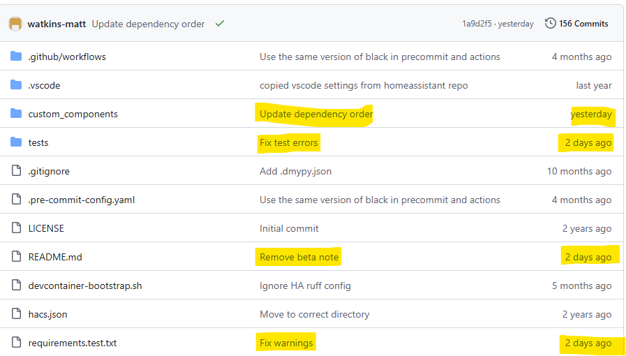

When you’re using a custom integration and it fails, it’s always a good move to report the issue to the developer of the integration and provide the relevant errors from your error logs.
Fortunately someone has already done so, and the developer has addressed the incompatibility with the 2025.7 version of home assistant.
Error with Home Assistant 2025-7-0
Thanks Matt Watkins
