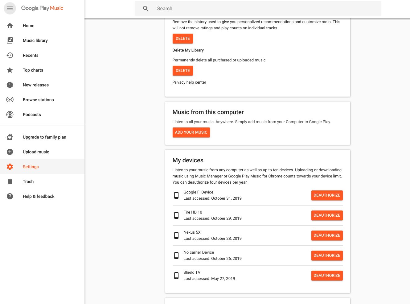

Hi, I tried to recover the ID, but it only gives me the long one, I can’t find the short one (android?)
this the log when i hit play:
2019-10-31 17:42:46 ERROR (SyncWorker_9) [custom_components.gmusic_player.media_player] Failed to get URL for track: (0f50f56f-8ae8-39a5-bdea-3a690823b703)
2019-10-31 17:42:47 ERROR (SyncWorker_9) [custom_components.gmusic_player.media_player] Failed to get URL for track: (2e67b6d3-aac1-3271-a33c-41047bcf18f7)
2019-10-31 17:42:47 ERROR (SyncWorker_9) [custom_components.gmusic_player.media_player] Failed to get URL for track: (09f50bab-2cbf-34ca-9b87-ee86b4327e97)
2019-10-31 17:42:47 ERROR (SyncWorker_9) [custom_components.gmusic_player.media_player] Failed to get URL for track: (36b2a8ac-8bd3-3894-ac9a-8c0ece109748)
It’s not gonna work with that long ID. It has to be the shorter android ID. Do you have an android device resisted to the same account your trying to use here? If so, install Google Music and login from the android device. This should register it’s device ID.
Also from the Google music web page, If you log in and go to setting you can see what devices are registered to your Google Music account. You must first see an android device in this list before gmusicapi will return it’s ID in the gmusic_player logs

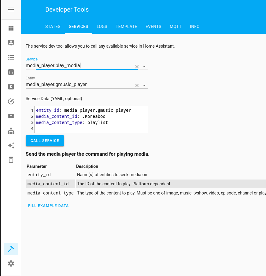

Any idea what this might be? I did create a Github issue as well, with some images of what I’m experiencing.
PS: Outside of the US, but I have a full access account.
@Padrone56 Welcome :slightly_smiling_face:

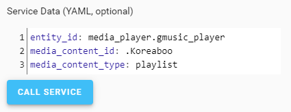

:thinking: I had a look at your pictures on github. I have a guess… can you try to start playback using media_player.play_media from the services page.
Based on you pictures try one or both
playlist
entity_id: media_player.gmusic_player
media_content_id: .Koreaboo
media_content_type: playlist
station
media_content_id: I'm Feeling Lucky
media_content_type: station
No luck :confused:
I call this, but nothing happens and the logs are clean. The player just stays turned off.
This is my first custom component install, so I feel like I might’ve botched the installation or something. Does the Music Player require anything else to be installed?
I have a Kodi media player and it works fine. Have you setup your player correctly in gmusic_config.yaml
