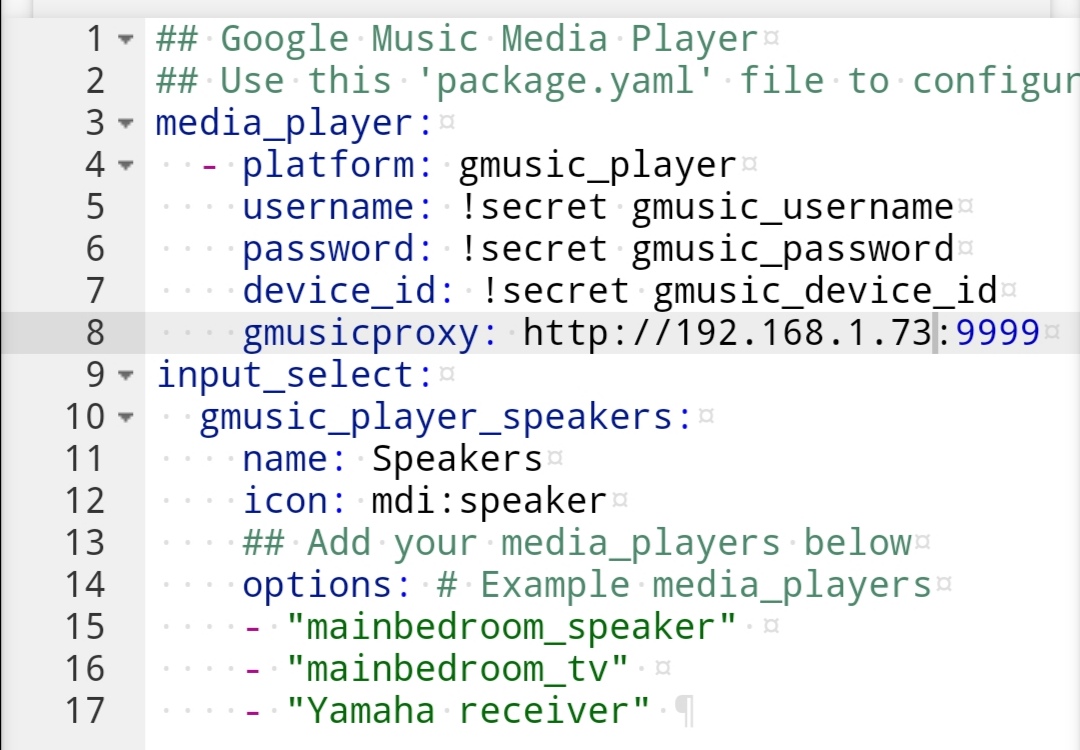

Thanks, how do I make the play ists play, the stations play but the songs advance faster, I am busy setting up gmusicproxy, so in summary here are my issues:
1.playlists not playing,
2. Which url to use for gmusic proxy, currently using the hassio one but this has stopped even the stations from playing, see attatched yaml
Seems the gmusicproxy has had the negative effect, the stations no longer play, but after removing it, they play again, but advance before the song ends, I also still have the issue with play lists
yes you are on the right path – gmusicproxy is the only solution to stop songs from advancing to fast.
Your yaml looks correct to me. I’m sorry I do not use anything docker or hassio related so I can not be of much help here. ( I run Home Assistant Core on FreeNAS )
