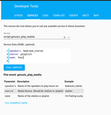

- added two scripts that will fire events to gmusic_player
gmusic_player.yaml
should be used as it is provided. There is no need to edit this file.
script.gmusic_sync_media
- Update playlist and stations without restarting Home Assistant
script.gmusic_play_media
- Easier way to start play black. You can use this in automations
- This will also set the corresponding input_selects

- name: Sync Music
icon: 'mdi:sync'
type: script
