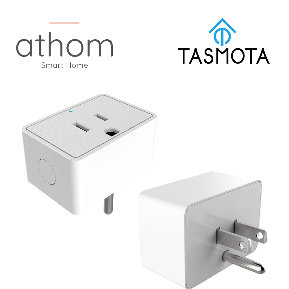

US version available for anyone finding this thread later:
