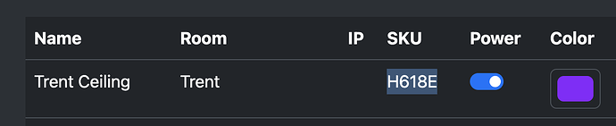

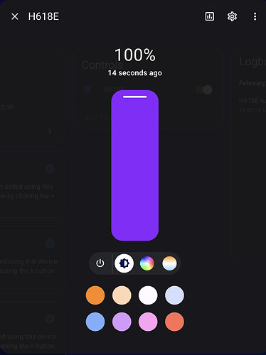

Just added my Govee strip to HA using Govee2mqtt and it’s working flawlessly, and it’s really responsive.
It’s a RGBIC strip, model H619A, and I have access to all the effects, each LED has its own entity so I can control them individually.
I didn’t expect much from it and it was the last device I wanted to add to HA because I thought it’d be a pain, but it’s not.
Tried the official integration first but I pretty much only had a ON/OFF switch ton control it.
