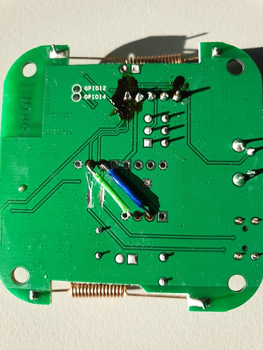

I gave up with broadlink because it was too fiddly and I just went down the Sonoff RF bridge tasmota firmware portisch router. Way more hassle to flash but once done it worked every time.
Shout if you need help flashing the portisch firmware then shout.
If you can offer any information on flashing the RF bridge with this firmware I would appreciate it. The information I found is not very clear.
Thanks
  1. remove/bend the light from the board (plenty of guides on that)
  2. turn the physical switch to off
  3. flash tasmota RF (standard one is RF compatible) using a flasher like this
    ch340ghttps://github.com/arendst/Tasmota/releases/download/v8.3.0/tasmota.bin
  4. choose Bridge in setting of tasmota
do as above but do don’t cut the tracks, just use the USB flasher to power the device while flashing. I never soldiered I just used jumper cables which I later removed once working.
  1. flash portisch firmware and reboot
  2. from the tasmota console issue run rfraw 177 to sniff button presses on remote.
  3. convert results using online converter. http://bbconv.hrbl.pl
  4. add converted codes to HA config
