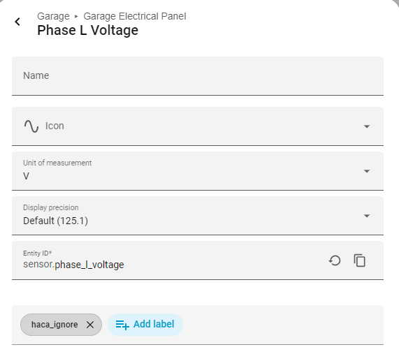

I am on 1.7.3, but I am still getting a number of entities in the performance section even though I have applied the haca_ignore label to all of them.
A new system has been created for noisy entities. It is available in version 1.7.4 on GitHub, but has not yet been released. You can try it with a manual installation.
