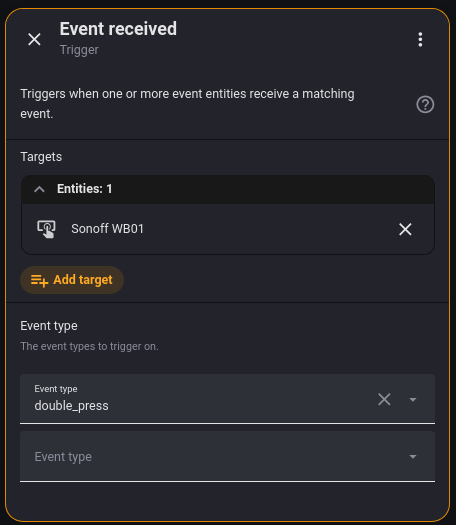

Event Received Trigger:
This is the new kid on the block; part of the “purpose-specific triggers” that dropped with the 2026.7 update. It requires an event entity, which haven’t been added to ZHA yet. If you want, you can create your own using a trigger-based Template Event.
Template Event Example
template:
  - triggers:
      - event_type: zha_event
        event_data:
          device_id: 7aa398b79ccd6f3f2001b529e13b5b95
        trigger: event
    variables:
      command: "{{ trigger.event.data.command }}"
      command_action:
        "on": double_press
        "off": hold
        "toggle": single_press
    event:
      - name: Sonoff WB01
        unique_id: event_sonoff_wb01_00001
        device_class: button
        event_type: "{{ command_action.get(command, 'single_press') }}"
        event_types: "{{ ['single_press', 'double_press', 'hold'] }}"
