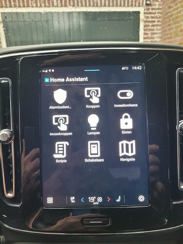

I installed the AAOS companion app in my Volvo XC40. On the home screen of the app I can select the category of the entities to display. This works well for 7 out of the 9 categories, but not for the categories Buttons and Switches. For these I get the message Home Assistant does not respond even after multiple times pressing Wait. It might have to do with the number of entities in these categories (60+).
It would be nice if I had the possibility to just show a selection of the entities on the home screen. I have nearly a thousand entities in my home assistant installation. and only 10 or so are relevant in the car: gate opener, some lights, perhaps a thermostat setting.

this should be fixed now in the latest release, if not please file an issue on github so we can get it corrected.
