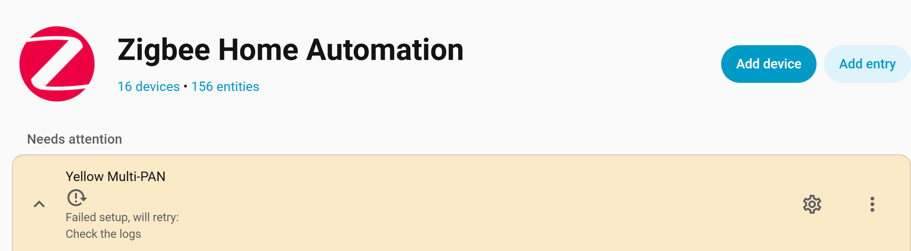

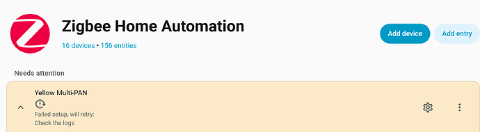

I removed the Multiprotocol and after that I restarted HA, but the Zigbee does not work.
I saw that ZHA is still looking for the Multiprotocol:
How do I change that ?

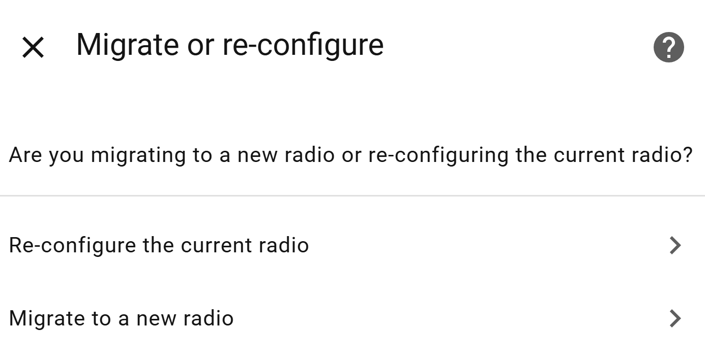

You need to reconfigure ZHA
I tried new radio in:
but it does not find new radio
