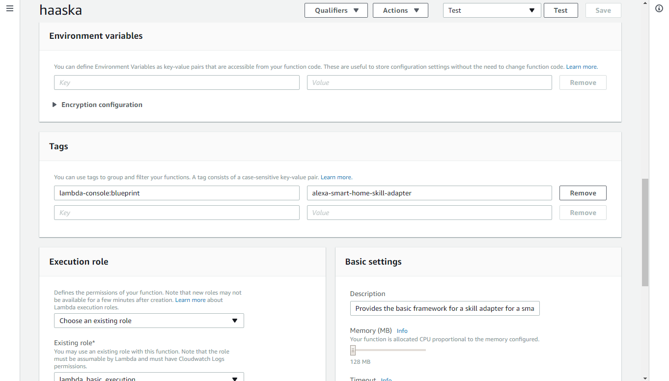

Great. And you have put that (along with pasword) in to the config.json file before you created the zip using “make”? In which case, a few settings you should check within the lambda:
  • The lambda is called “haaska”.
  • You have Alexa smart home as a trigger, and amazon cloudwatch logs as a resource.
  • Run time is python 3.6 and Handler is haaska.event_handler
  • You’ve uploaded your haaska.zip for the code and you can see it as haaska.py in the lambda page.
  • execution role is “Choose an existing role”! and then “lambda_basic_execution”.
Everything else shouldn’t really be touched.

Guess what, no more errors after I change the timeout value to 20 seconds under “Basic Settings”. I can see my devices in json under details. However, they are still not discover in the Alexa app.
