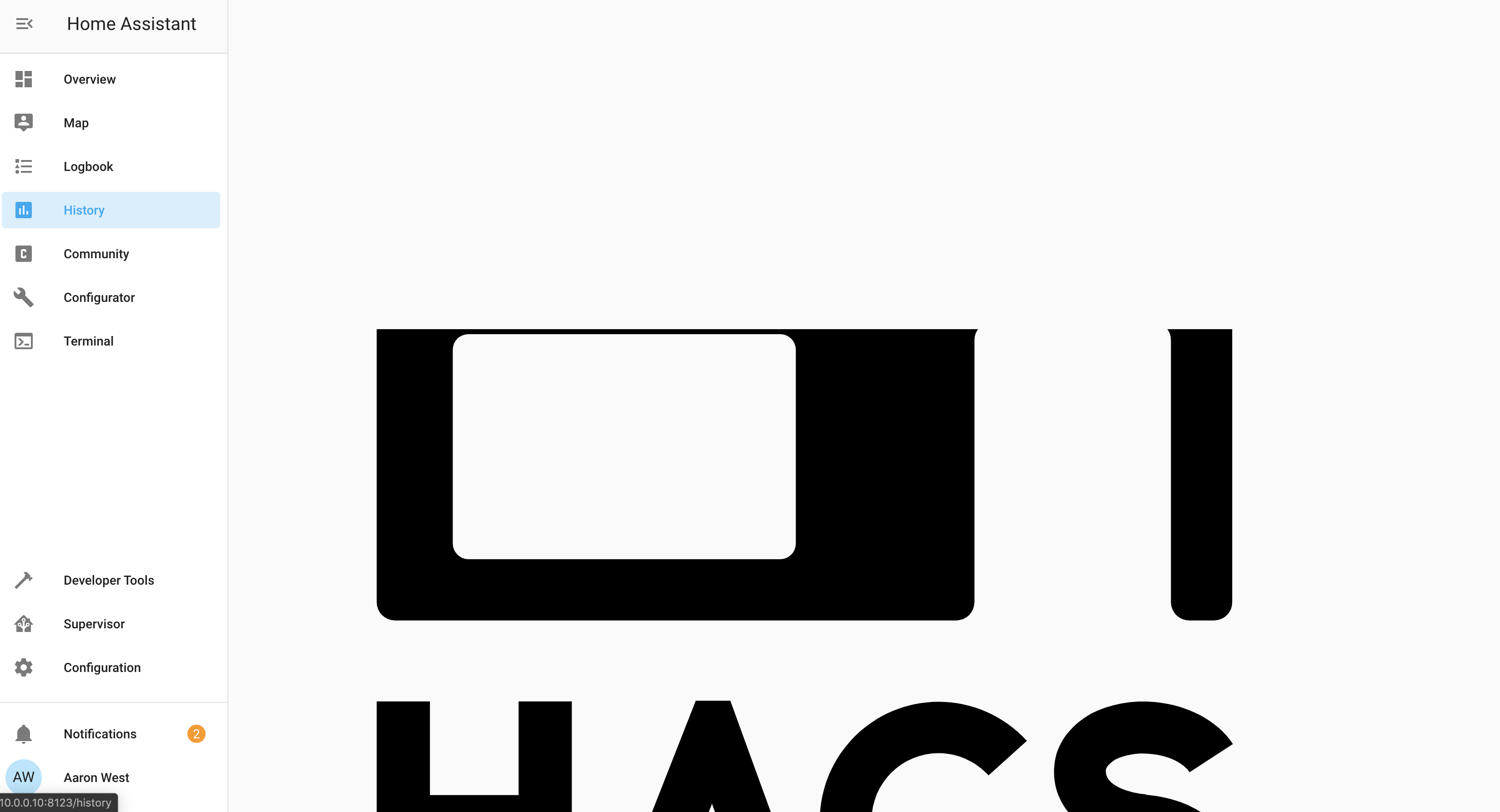

This background lives on every page of my HA if I scroll down

I cleared the cache, used a different clean browser, all I could think of.
Every page I first open, the black text appears shortly, for half a second, then it dissapears.
The only page it remains visible is HACS.

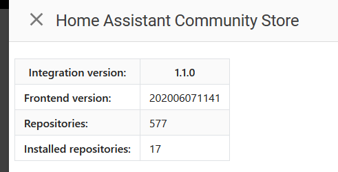

Did you update HACS and restart?
Yes, HACS is the latest version.
HassIO was restarted numerous times since.
@ludeeus Do you have any idea what could be causing this and how to fix it?
I’ve just updated to HACS 1.1.1, with no effect on this.
Thank you!
I just updated to the latest HACS (1.1.2), restarted HA, and then shift+F5. The HACS image is now gone. Thanks for the tip!
