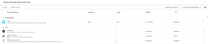

HACS doesn't show downloaded integrations
i just checked the HACS and under “downloaded” there is only HACS listed. All other integrations that i downloaded via HACS are not shown:
If i go to the HACS integrations, there are all downloaded integrations shown as device:
Is this normal?
Thank you very much.
