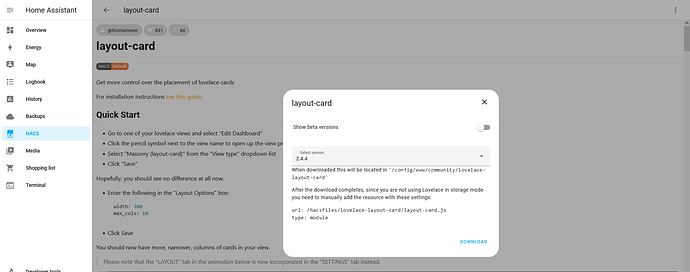

2. Go to `/hacs/frontend`.
3. Click on `+`, search for any card.
4. Install it.
5. Observe it doesn't work. No error message, no warning.
6. Try to reinstall it. Still doesn't work.
7. Alternatively, find an already installed frontend card and uninstall it. Observe Lovelace will still try to load the removed JavaScript file.
No matter what combination of reboots or clearing cache, lovelace resources aren't updated by HACS.

Out-of-the-box, installing front-end modules through HACS is broken/incomplete: After clicking (re)install, a user would expect to have it fully installed and ready to use. However, that's not the case anymore.
On a basic/default/empty lovelace configuration (I believe most users start out like that), HACS will no longer update lovelace resources, leading to frustration, confusion, extra manual work (which kind of defeats the purpose of HACS). This is specially confusing for users updating from an earlier version (when things "just worked") to a later version.
