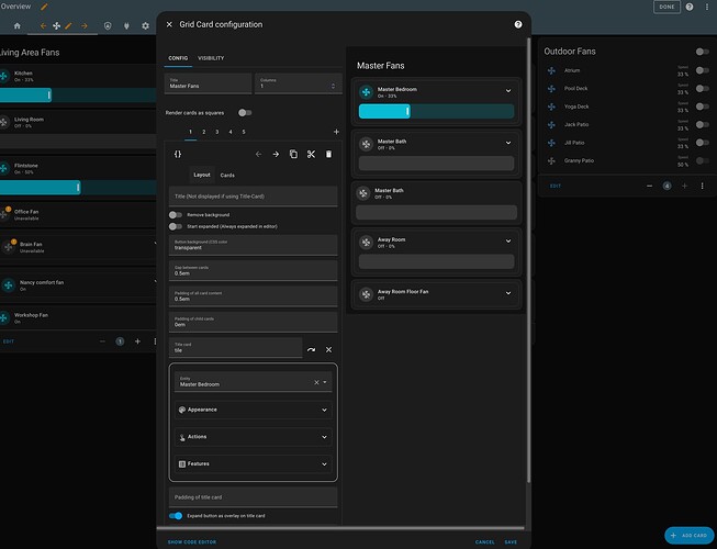

When editing the dashboard, if I click on a card, the card will popup and open, but then will redraw/refresh approximately every 5 seconds. I don’t see anything in the browser’s developer console that would help me understand why this is happening. The result is that any changes you make get flushed before you can make a change, unless you can do it in under 5 seconds. I can work around this by editing the YAML in the same popup.

What type of card are you putting in the grid card?
If it is the tile card then I can not reproduce this issue.
Must be a third party frontend resource you have installed.
I was thinking it was a general problem, and my bad for not posting the YAML. I see now I have a lot of HACS updates pending. Extra malo for letting my memory slip, due to being away from HASSIO for quite a few months.
BUT, even after updating everything in HACS, I still have the problem.
This example does the redraw.

It’s the expander-card… :frowning: It’s a known issue, there are some forks of the original (unmaintained) card, but all of them still have some issues, unfortunately!
Take a look at this feature request, there are the forks linked, so you can try, if one of them works for you.
Thanks very much for this response. One less gremlin to hunt down.
Watch this topic, someone seems to have picked up the development of the card. Can’t say for sure, but put it on your watchlist, maybe something comes up! :slight_smile:
