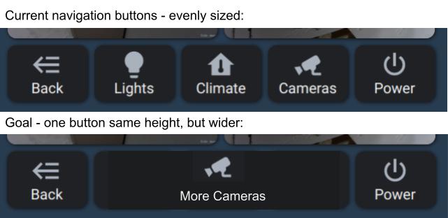

I"m splitting one page into two, and so I want to emphasize one button by making it 3x or 4x the width.
Top is what I have currently, bottom is what I want to do:
nav buttons
Since real estate is at a premium, it’s important that row of buttons stays at that slim height.

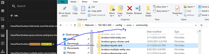

There’s a required step to add a “resource” (the top one is the one in question) - this screenshot shows the most recent URL attempt:
At Configuration → Lovelace Dashboards → Resources → “Add Resource”
I’m finding conflicting info on what to actually set the resource URL to (I’m not trying options from YAML mode as I am not using that and don’t have a ui-lovelace.yaml file) so I do suspect this is the issue.
Actual path confirmed as /home/homeassistant/.homeassistant/www/community/lovelace-layout-card.
Layout-card.js does for sure exist there:
  • That screenshot is my last attempt - the actual install path: /community/lovelace-layout-card/layout-card.js.
  • The HACS UI (HACS → frontend → Layout-Card) explicitly says to use “/local/layout-card.js”.
  • Card author installation instructions describe “/hacsfiles/” as the start of the resource path (additionally described as replacing the “www” of the actual install path).
  • Solution in this very similar topic states that “/community_plugin/” is the start for that path where I have /community/
  • External thread showed one additional option (besides others I tried): /plugins/layout-card.js
All yield the same error. Not finding the javascript file I presume, since I’m getting
“Custom element doesn’t exist: layout-card.”
I feel like this should be pretty straightforward since I know my install path - what’s the magic formula, given that path, to produce the correct resource URL?

Click the Plus to add a new resource. The url is the path to your downloaded file. Replace <config directory>/www/ with /local/ .
So how do I get the correct URL (for the resource)?
here is mine
now if i do
think you need to look at your paths again
You are pretty close- I just happened to figure it out as you were posting that.
I was just playing with them again, couldn’t believe “/local/community/lovelace-layout-card” wasn’t the correct path.
It started to work when I included the file in the path:
/local/community/lovelace-layout-card/layout-card.js
That’s the missing link.
