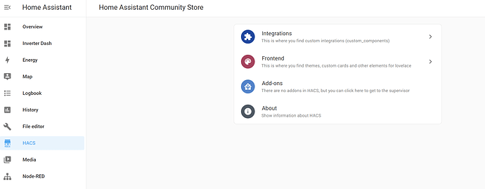

Hello, please look at the attached image:
Doesn’t HACS look different? I see no Integrations, Frontend and other sections anymore…
I can’t even add any custom integration anymore. If I click on the menu, it just doesn’t do anything.
Please help on this.

At some point the new interface will be no longer experimental, so maybe get used to it? I’ve been using it for a while, and haven’t had any problems with it. You can add new repositories in the top right three dot menu, and add the integrations from it with the button at the bottom right. What is the problem, besides it looking different?
Edit: oh wait - I think I understand the confusion now, because I too can’t add a new integration the old ways as the button is now gone… It was there in the OP’s screenshot. It seems it was changed. You just need to search and when you find the integration you need open it and there’s a download button.
If you want to see the ones you have, you can filter on the downloaded ones.

But after a reboot of the entire (new) host I can only see the screen below on the new HA instance when I select HACS in the sidebar. I’m used to see the interface showing a list of Integrations, Frontend, Automation, Add-ons, About. but this is just not showing up.
