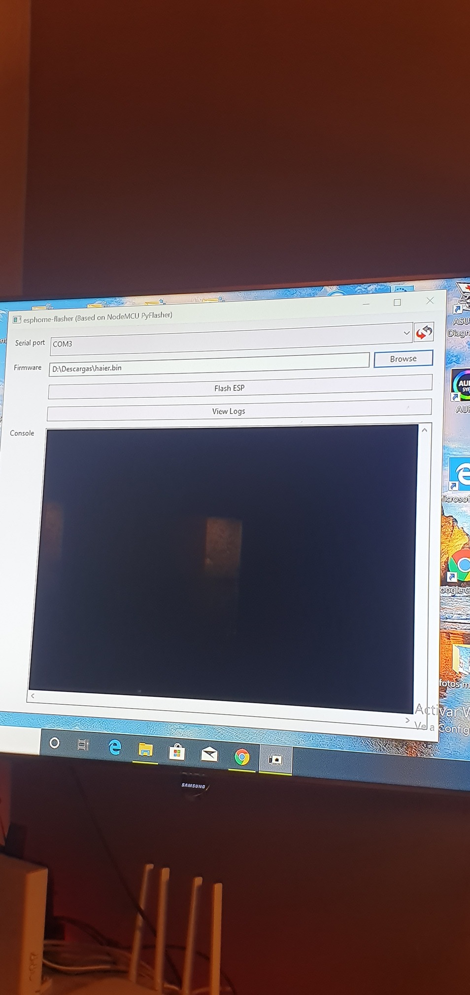

I made a “custom firmware” for Wemos D1 with ESPHome.

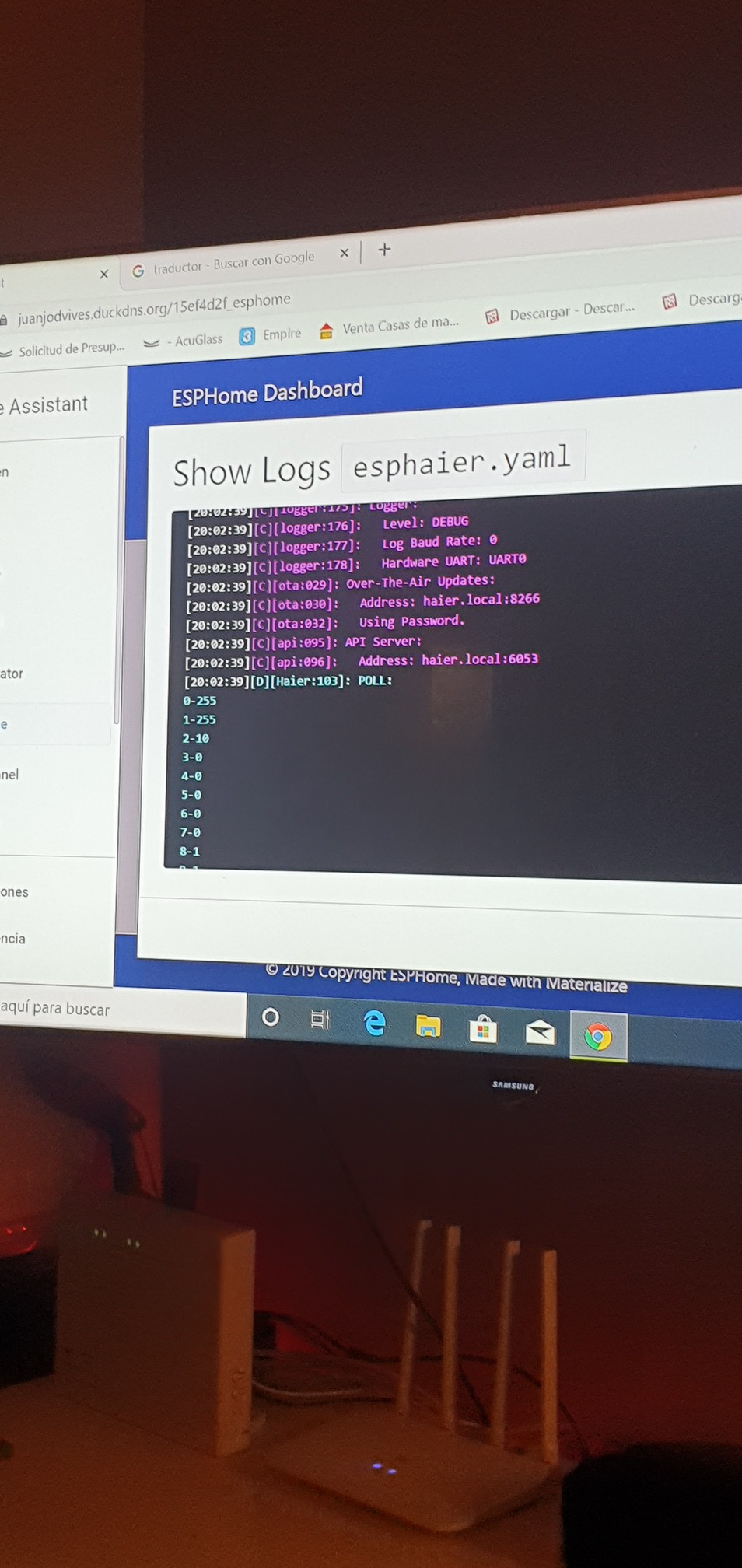

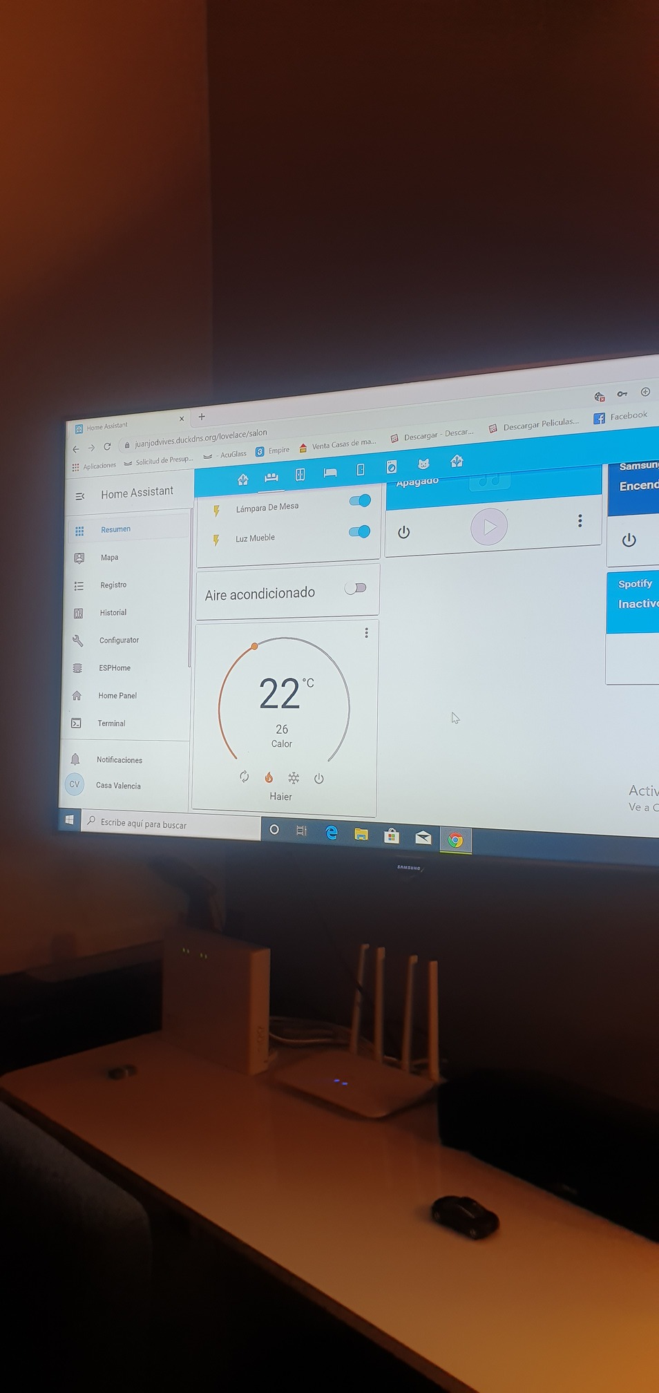

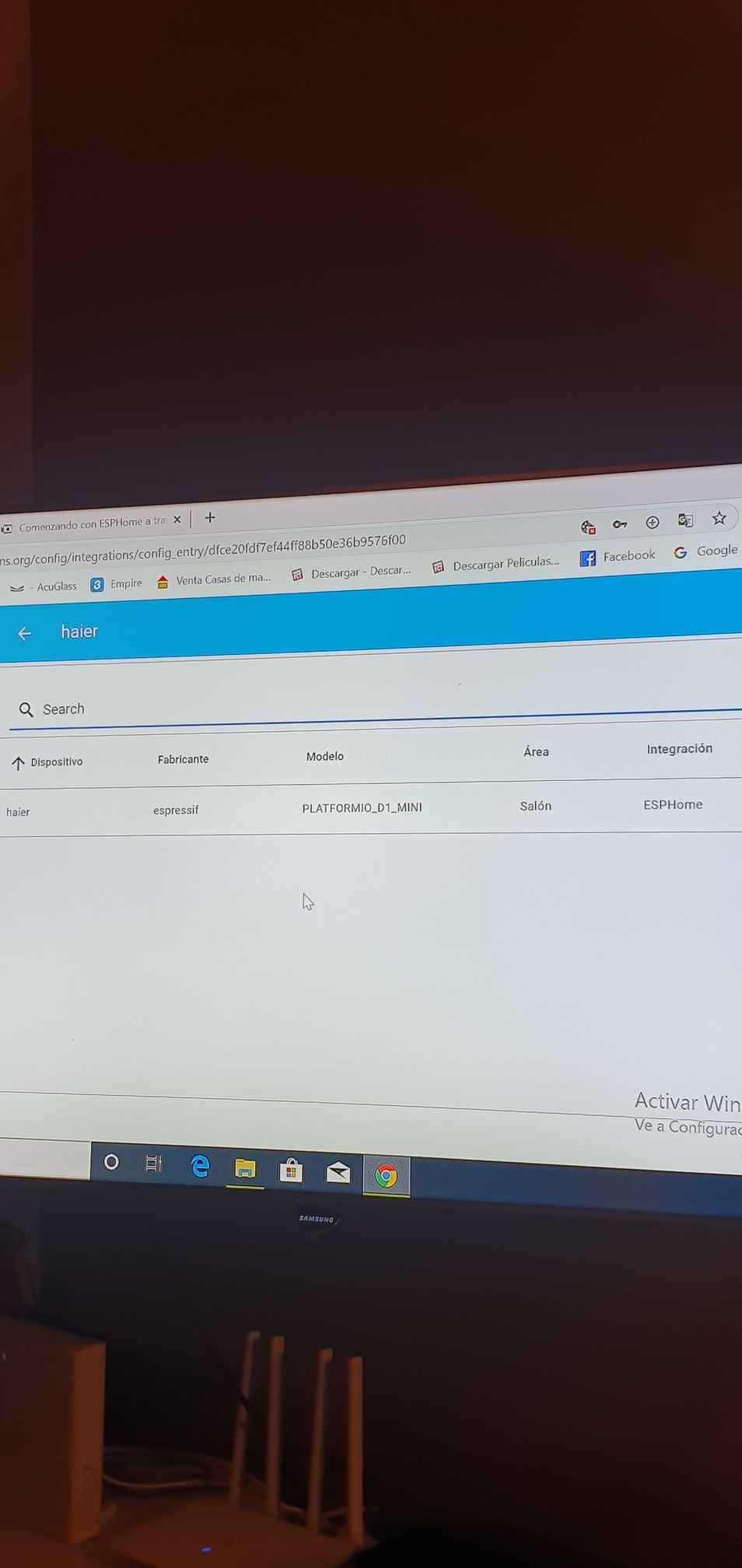

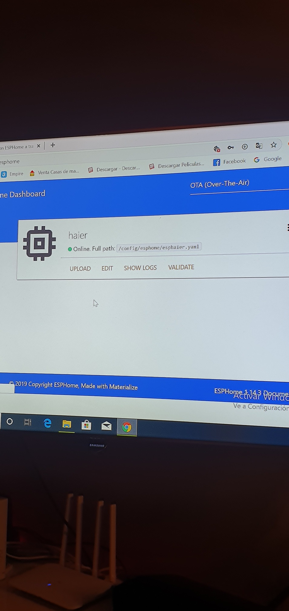

Hi MiguelAngelLV I congratulate you on the project, could you help me? I don’t get it to work, thanks. :sonrisa_sudor:soy bastante novato.
Um… It look working. What is it the problem? Home Assistant recognize the device.
PD: The router is a Xiaomi 4C? I have one too xD
If it is a xiaomi 4C, :riendo: take assistant recognizes the device but does not turn on or off the air conditioner and does not tell me its status either, esp8266 receives a signal but does nothing
Send signal but does not turn on or do anything.
How does it connect to the air conditioner? With the USB adapter or directly? I have it with the USB adapter, excuse my ignorance.

Unfortunately doesn’t work for Haier AS25NHPHRA
No any “Readed message:” in Wemos log… Only something like:
[D][Haier:103]: POLL:
0-255
1-255
2-10
3-0
4-0
5-0
6-0
7-0
8-1
9-1
10-77
11-1
12-90
[D][climate:010]: ‘Haier’ — Setting
[D][climate:014]: Mode: OFF
[D][Haier:215]: Sended message:
0-0
1-0
2-0
3-0
4-0
5-0
6-0
7-0
8-0
9-1
10-77
11-95
12-0
Maybe use other protocol or require a specific message.
