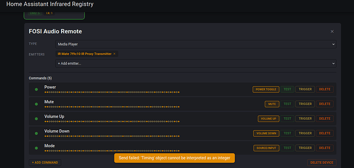

Using a Seeed studio IR Mate, I'm able to sniff codes, but I get the same error whenever I try to transmit any of the sniffed codes:
Send failed: Timing object cannot be interpreted as an integer
IR Mate config

Hey @Didgeridrew, thanks for the report and the screenshot, really helpful! :grinning_face:
Good news: the Sniffer working means your RX pipeline is set up correctly. I looked at your ESPHome config and it looks solid ~ the ir_rf_proxy setup for both TX and RX is correct, and the on_pronto: bridge is wired up properly.
The TX error is interesting. We tested the same send path on our ESP32-based emitters (generic builds, not the IR Mate) and TX works without issues. The "Timing object cannot be interpreted as an integer" error points to something in the send chain between HAIR and the ESPHome device, but it's not something we can reproduce on our hardware.
To narrow it down, can you share a few things?
  1. Your HA version (Settings > About)
  2. Your ESPHome version (ESPHome dashboard > top right)
  3. The full error traceback from your HA logs (Settings > System > Logs, search for "Timing" or "infrared" after hitting TEST on a command)
The version info is key. The error message suggests something downstream from HAIR is rejecting the timing data format, and we want to see if you're on a different HA or ESPHome version than what we're running (2026.4.4). The full traceback will show us exactly where in the chain it fails.
Also curious: do you have any other ESPHome IR transmitters (non-IR Mate) you could test with? That would tell us if it's IR Mate specific or a broader issue on your HA instance.
Side note ~ we've been wanting to get our hands on an IR Mate for a while but they've been sold out every time we've checked. Really glad you're testing with one, and happy to work through this with you.
~DAB

Hey @Didgeridrew, good news, we found it and pushed a fix.
Root cause: HA 2026.5 ships infrared-protocols v2.0.0, which removed the Timing dataclass entirely. The get_raw_timings() return type changed from list[Timing] to list[int] (signed microseconds). HAIR was still producing Timing objects via a fallback stub, and when the ESPHome emitter on 2026.5 tried to pass those directly to aioesphomeapi, it choked because it expected plain integers. This is an upstream breaking change that wasn't listed in the HA 2026.5 release notes.
Why your logs were empty: Our WebSocket send handler was catching the exception and returning it to the frontend, but never logging it. That's fixed now too ~ TX errors will show up in HA logs going forward.
The fix (HAIR 0.1.1):
  • ProntoCommand and RawTimingsCommand now return list[int] with signed microseconds
  • Works on both HA 2026.4 and 2026.5+
  • Error logging added to the send handler
Update HAIR through HACS and restart HA. TX should work after that. Let us know.

Thanks for the quick update. Everything seems to be working now.
