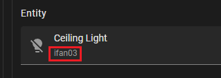

  1. On my card, if I select an actual device, there is a 2nd line that tells me the device
  2. But I can’t do the same with the AbstractLight, I was hoping it could show the ID of the actual device
Any ideas?
