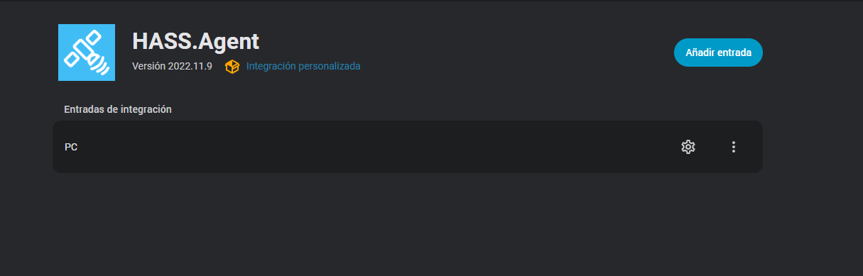

Since I updated to Home Assistant 2025.11, the integration stopped working. It remained unavailable, and after I re-added the PC, the sensors disappeared.
Works here perfectly…

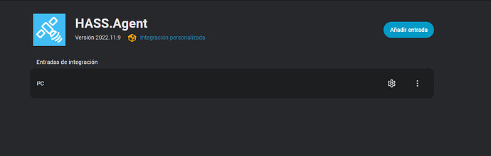

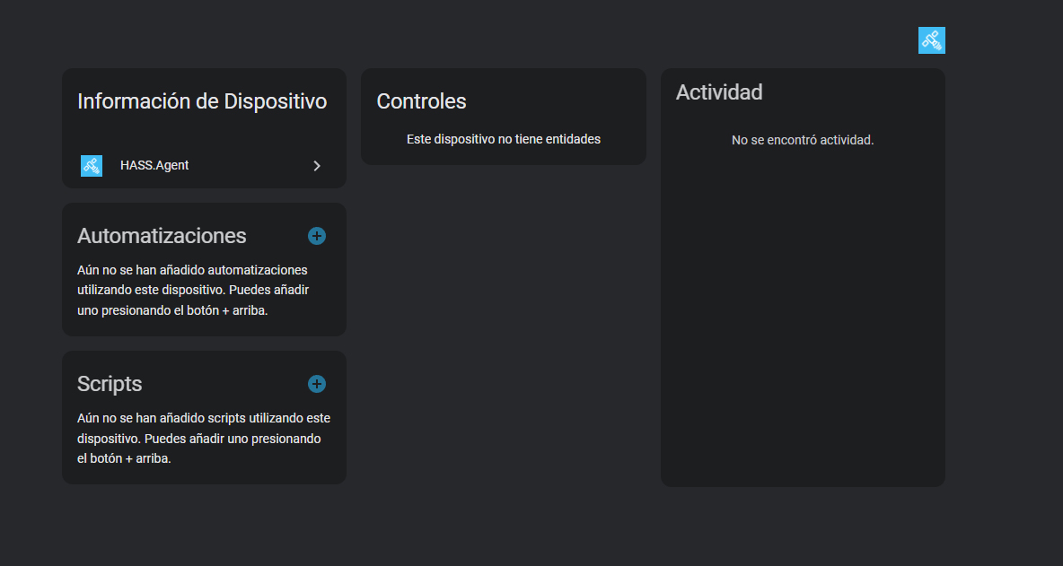

This is the only interface I see now, and I can’t log in or access it like I did before
Honestly, I have no idea what’s going on. Since yesterday, after updating Home Assistant, my HASS.Agent stopped working. I managed to get it to detect my PC again, but it doesn’t load any entities—even though I have sensors exposed, and I’ve added more, but nothing shows up. Can anyone help me? I’ve installed and uninstalled both the app on my PC and the integration in Home Assistant, but the issue persists.
Did you restart machine where HA runs? Not just ha restart, but machine - either power cycle pi, or restárt VM where HA runs…
I just restarted the Raspberry Pi and it still has no entities
From this screenshot, it looks you’re using the original HASS.Agent integration (and presumably, the agent as well).
I am using the forked version of the integration and agent, and everything is working fine here with 2025.11.0.
Thanks a lot, it’s working now! Looks like I had an old repository. Appreciate it!

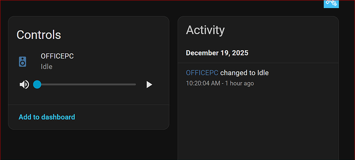

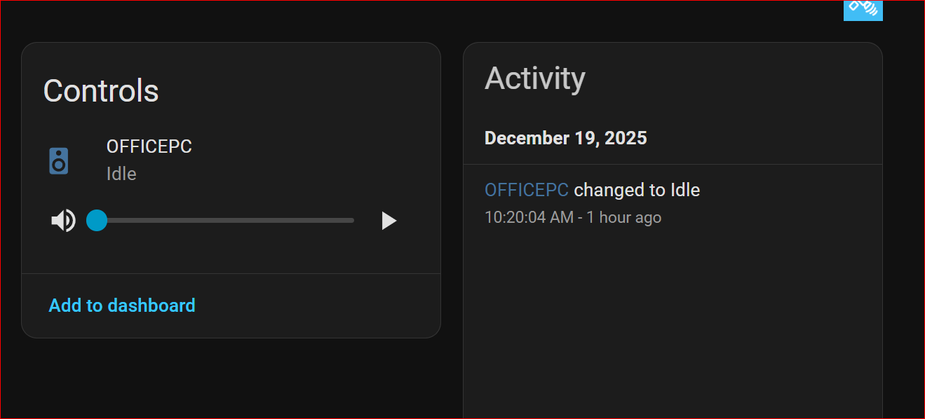

Only one of the Devices shows anything (screenshot attached) and not sure why, I dont even have the media player selected for it.

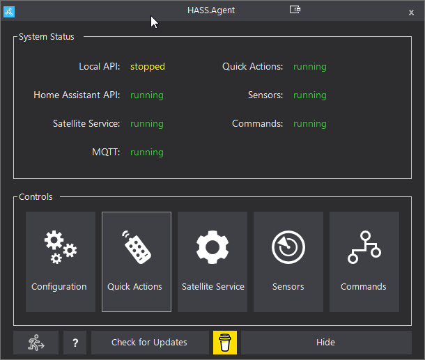

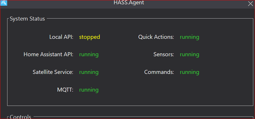

All PCs have service is running, and the local sensors are updating locally any ideas?
Sensors you add are not in “hass.agent” integration but in mqtt integration. Also set up API, it’s not running
Thanks, I expected those to show in the HASS Agent integration but yes, they are in MQTT.
What I read in the docs it looks like the API is optional, and no needed if you have MQTT? What features require the API?

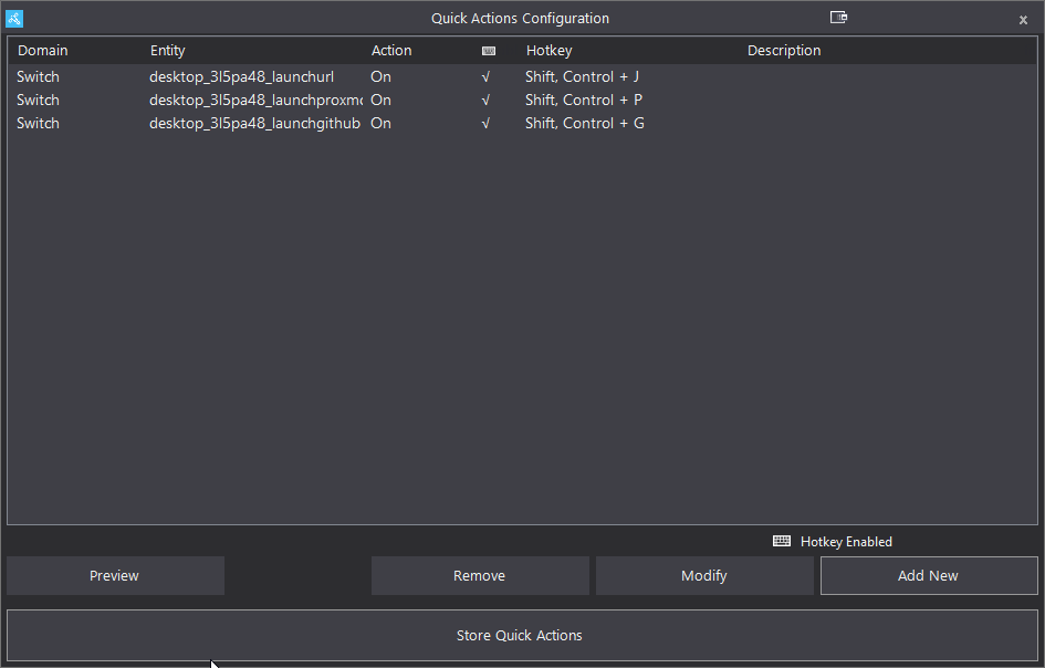

To use quick actions, you have to configure your instance’s API
It’s probably referring to Home Assistant API and not Local API. My quick actions are working with his exact status.

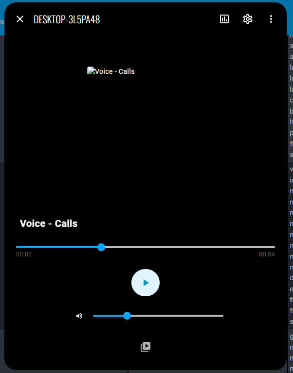

@duceduc: is mediaplayer working for you? Explanation in above “local API” is not very clear about that…

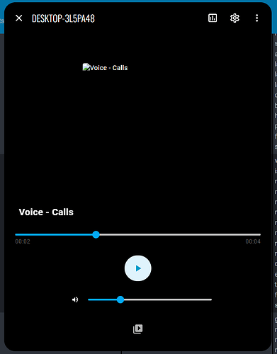

I don’t use the media_player. I opened the media_player entity and click play button and nothing happened. No errors either.
When I click on the play icon below, it opened my media folder and I selected a mp3 file. I can hear the file. Volume adjustment works as well. I don’t know how to stop the music though. Let it played until it finished.
