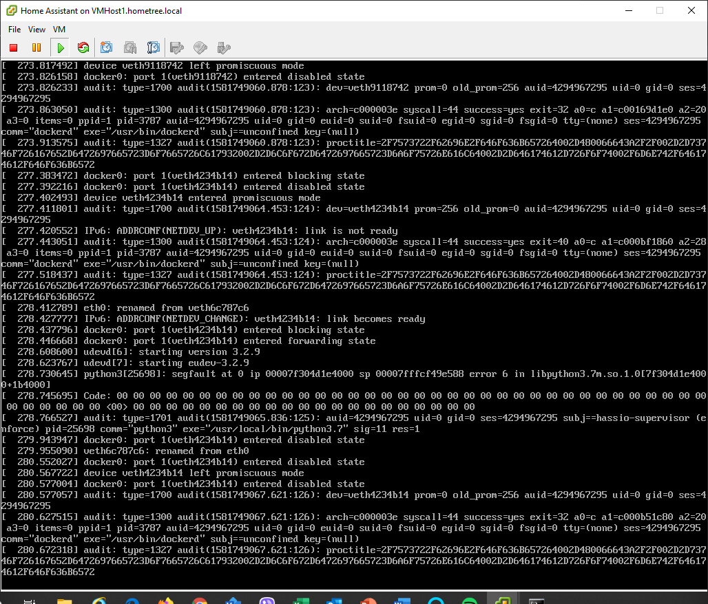

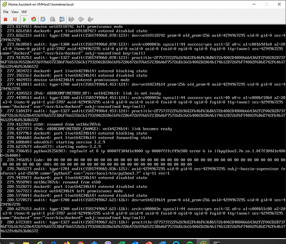

Yep, 192.168.15.x is the local subnet. For this, I have rebuild another esxi server and deployed another Hassio host vm. But it is still the same. On the same subnet, .35 last octed.
can you ping host ? you are using http right? and not https ?
do you have the righ ip?
Look for the IP with
  1. login
  2. ip a
because in the vmware Center its shows 192.168.15.4 and you said 192.168.15.35 (picture)
that .35 is probably on his other esxi server , so my guess the ip’s were right
Really appreciate your contribution. Yeah, Fabio is right. It is on second hardware. So! I’ve installed ESXi on a desktop this time, thinking the one on the laptop might have some low-level networking issue. But it was not the case.
