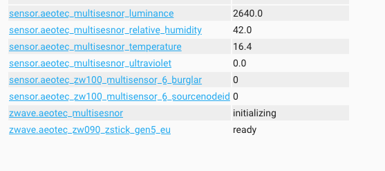

You got them all? Here’s what mine looks like in Dev Tools > States:
I think so:
