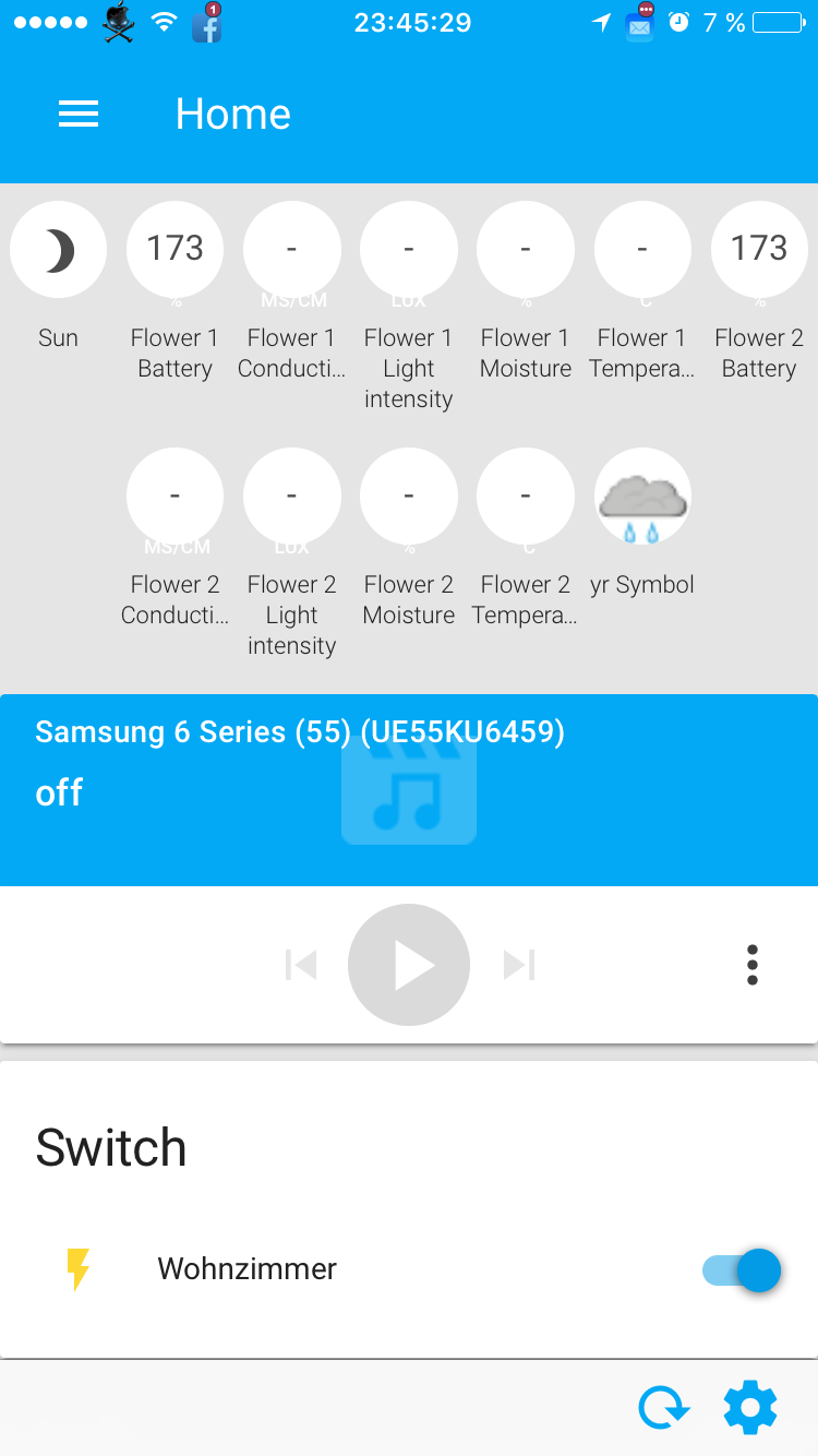

I have a Raspberry Pi 3 with a Hass.io Image and 2 Xiaomi Sensors i can see it but it shows me just the battery an this is 200% :sweat_smile:

It looks like either the gattool is not running or is not getting back valid data. I have no idea how you would go about getting it running on hass.io tho’ :confused:

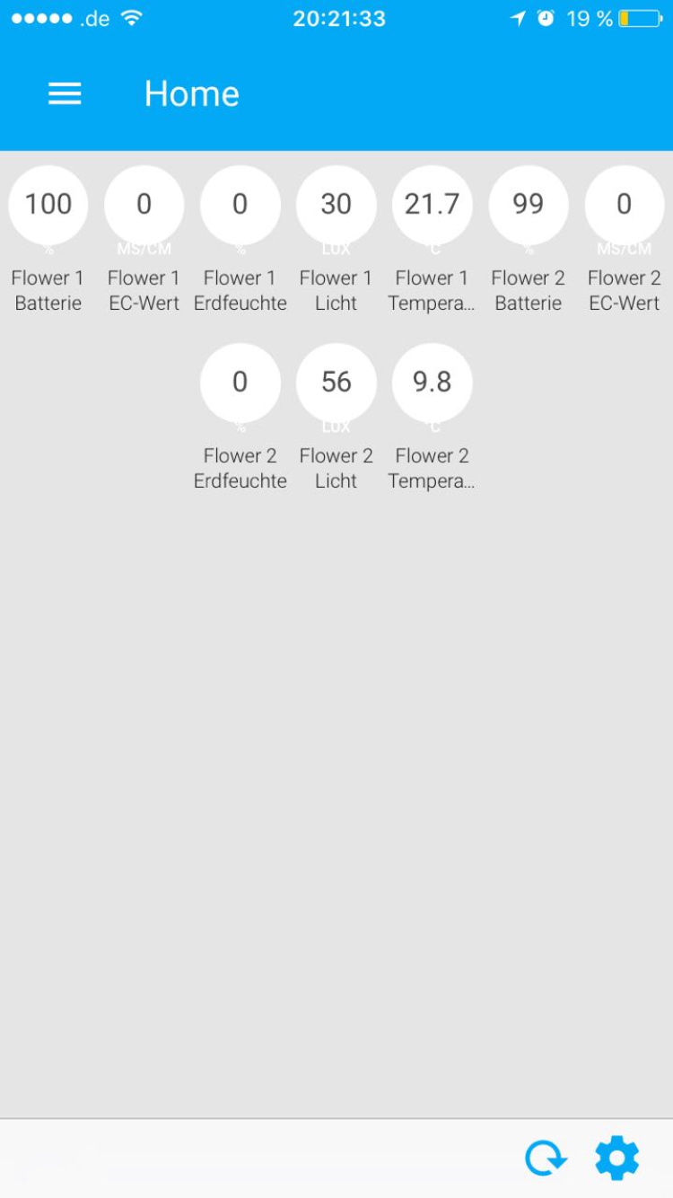

Fu** that was so simple but it works perfectly it was the comma. But how can i take sensor 2 in a extra row? Is this possible?
