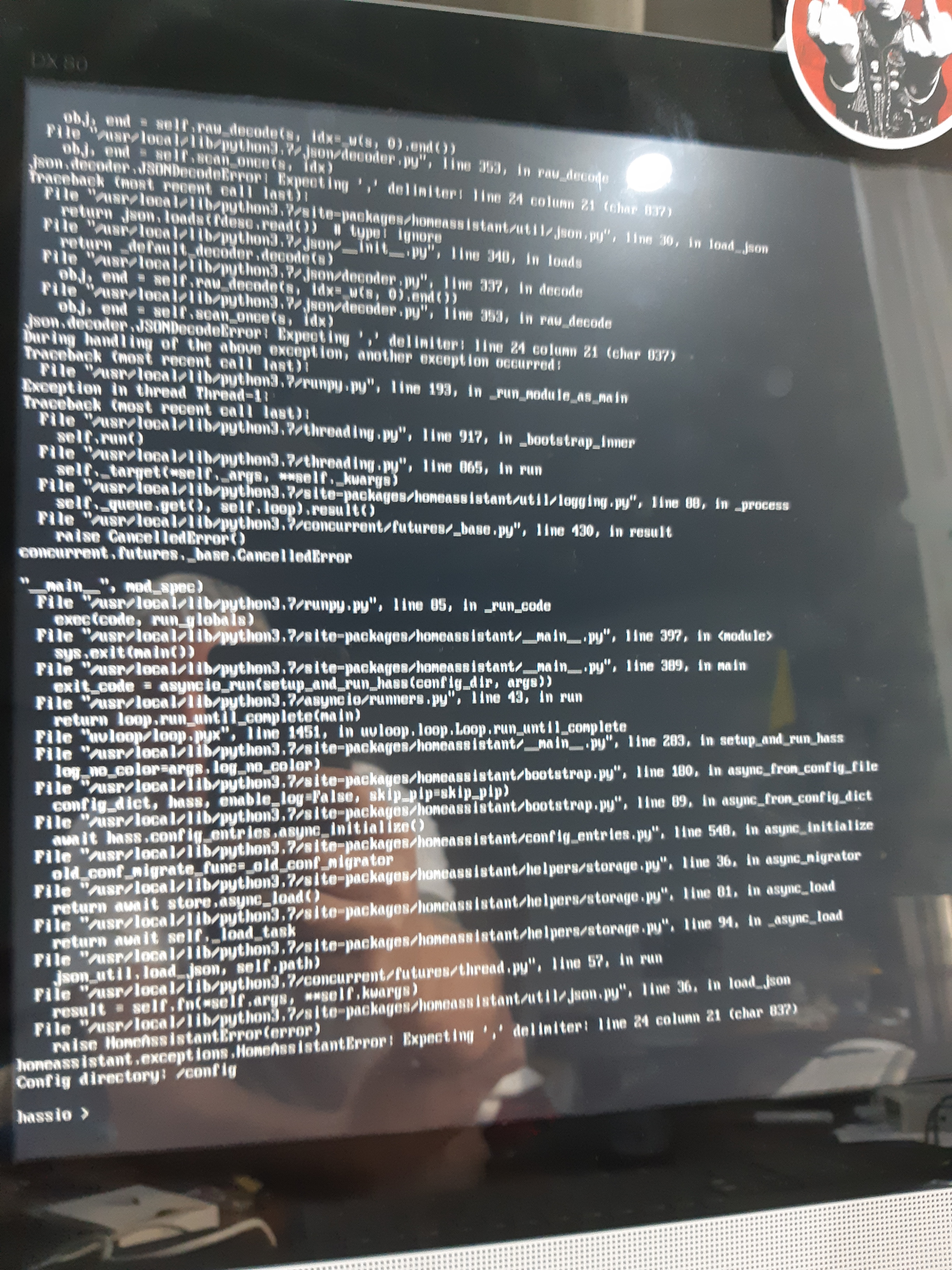

Been getting my first system set up over the last week (Node-Red, Tuya, HA entties) and just added z-wave. Was super happy when I got my first z-wave sensor talking to the aeotec z-wave stick.
Then, did a restart. My devices were gone. Tried to remove the z-wave configuration to re-do it, then the entire system won’t start. Can ping , no web on port 8123.

Seems to me you simply broke your configuration. Fix it and it will be fine.

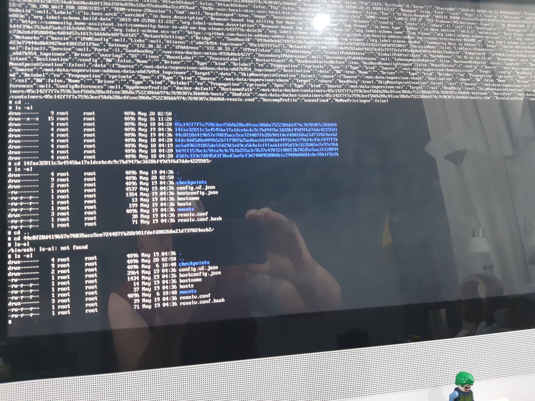

Hi M0e… I’m able to login # to my system.

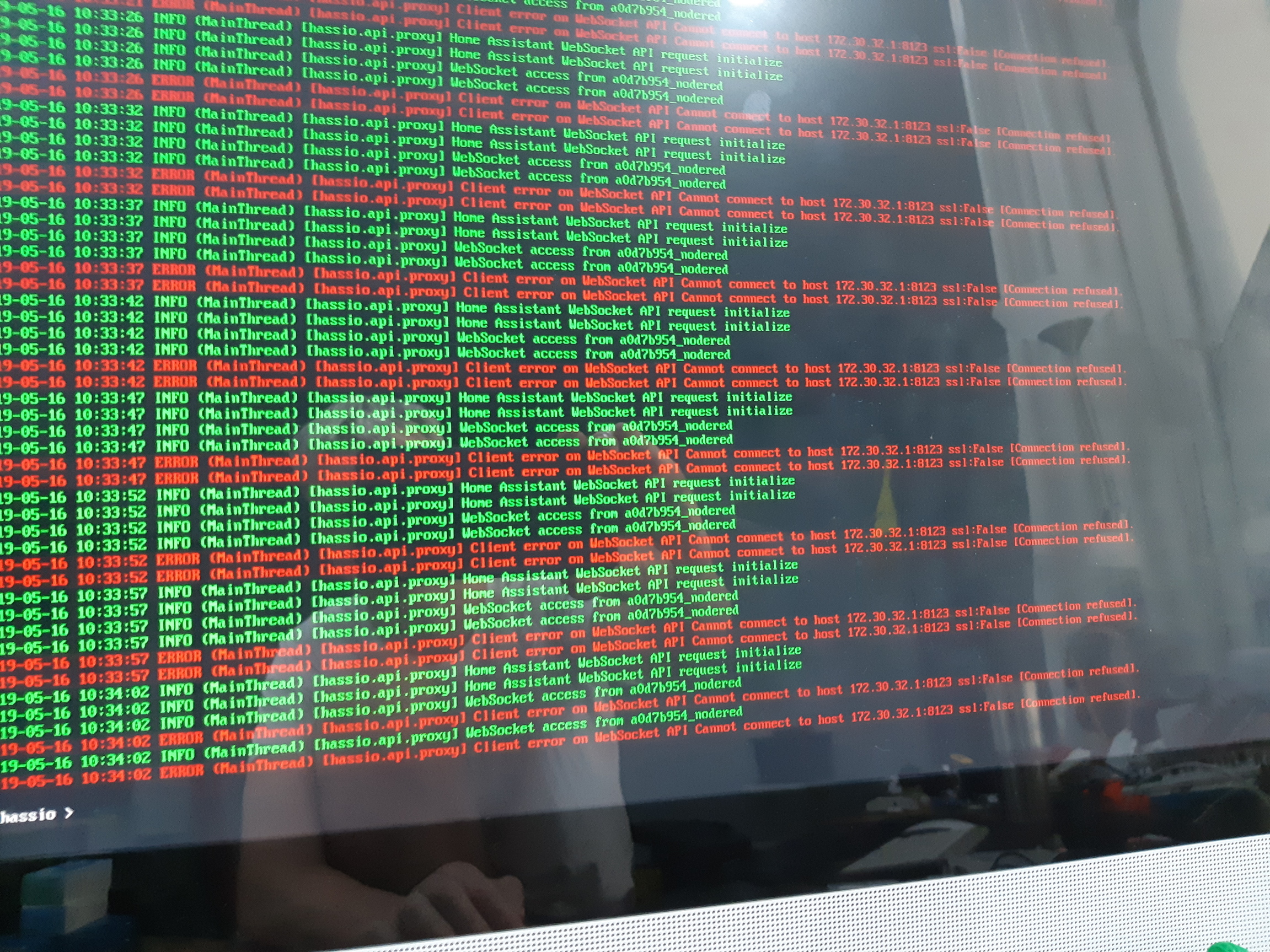

Although I’m able to see the logs (shows Connection Refused) in the supervisor_logs, the container bash isn’t accesble as it says “Container _______ is not running” from here - https://developers.home-assistant.io/docs/en/hassio_debugging.html
I cannot seem to find a config folder nor any directory containing the yaml files.

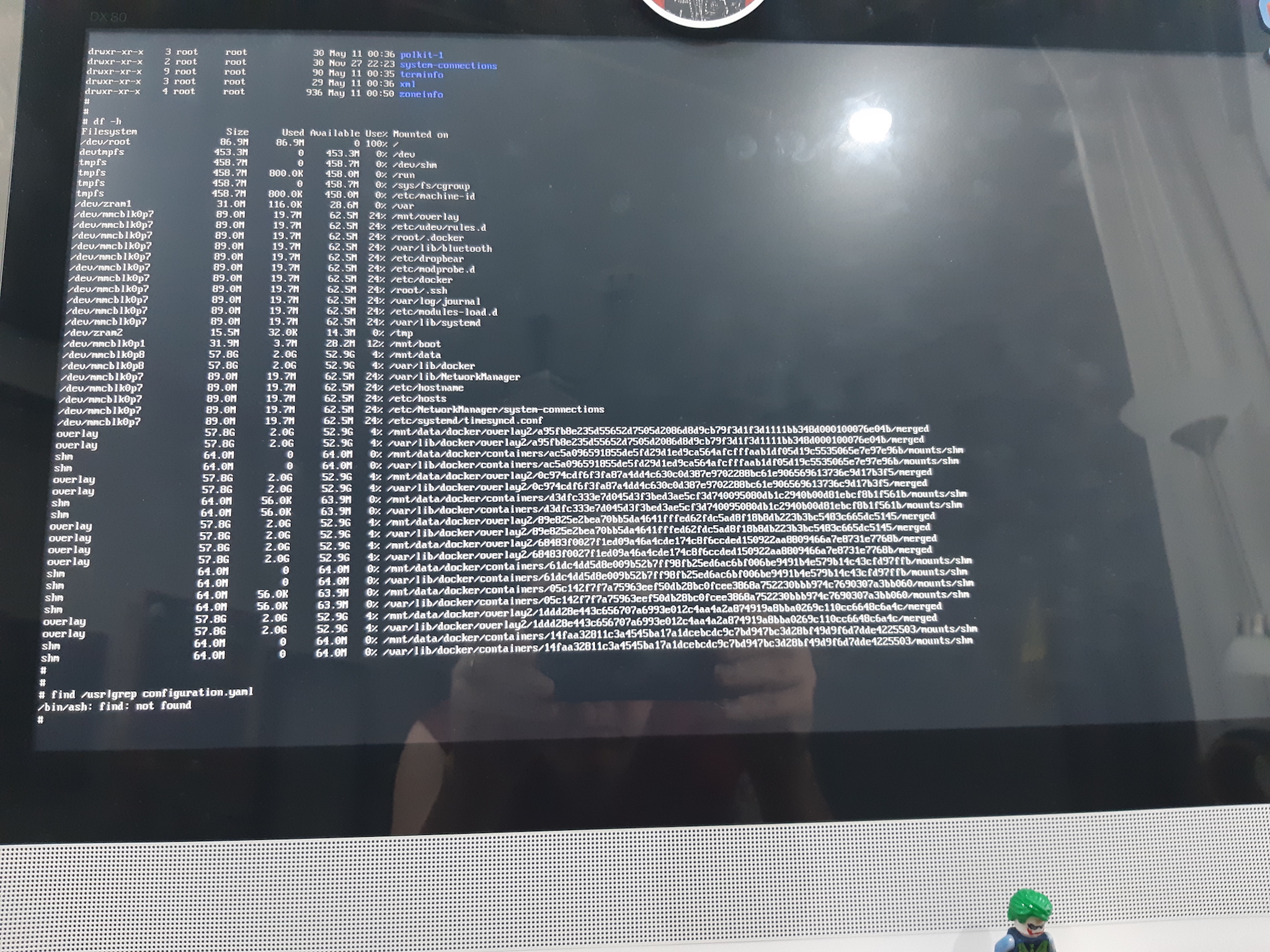

The actual path is mounted elsewhere, and it becomes blatantly obvious what that path is if you start looking around…df -h?
No. It’s standard, but you have to understand what’s going on in the background. It’s running docker.
When hassio is installed this way there is no /config. It is somewhere under /usr. As a rough and ready search do
 find /usr|grep configuration.yaml

I’m at a loss. I cannot seem to find anything.

It looks like you are in the host. Most probably you can now go to /use/share/hassio/homeassistant to edit the configuration.yaml
If you prefer a GUI you can run midnight commander in the host (sudo apt-get install mc) by running “sudo mc”. Then you will be able to browse and edit files a bit similar to Windows.
Pretty sure that’s only for a normal Linux distro running docker. HassOS is /mnt/data I’m pretty sure.
fversteegen,
There is not /usr/share/hassio folder.

are you aware of any documentation on the location of those files. My finders are truly breaking from going into directories and typing “ls”
I think there is no way to gain access to the system via console, as hassio > or # prompt.
