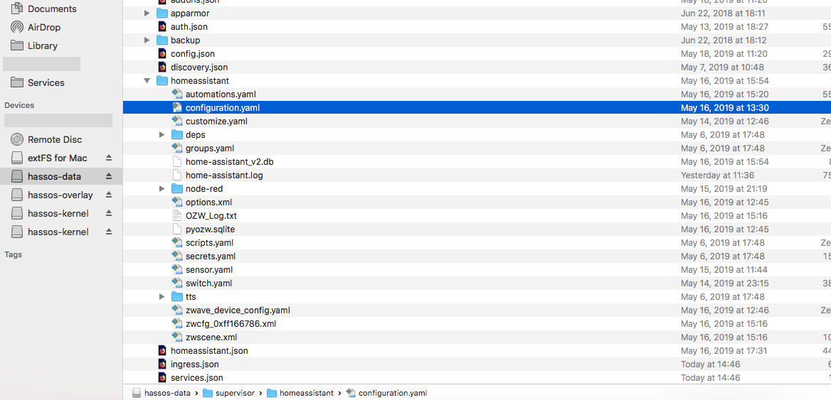

Found a solution!
use the extfs tool from paragon allows me to see the memory card details
Now I can remove the offening parts of my config…

Moveing the SD card over to a PC allowed me to see 4 file systems and the files I was looking for were easily found.
FYI, I was able to find the config files under /mnt/data/supervisor/homeassistant/, but this was a NUC using the VMDK with Proxmox. Not sure if the pi image is the same.
I’ve given up trying from the #> prompt and have edited the configuration from an external machine reading the memory card.
