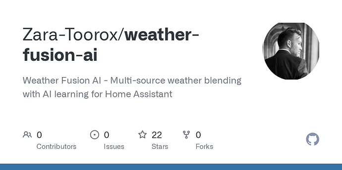

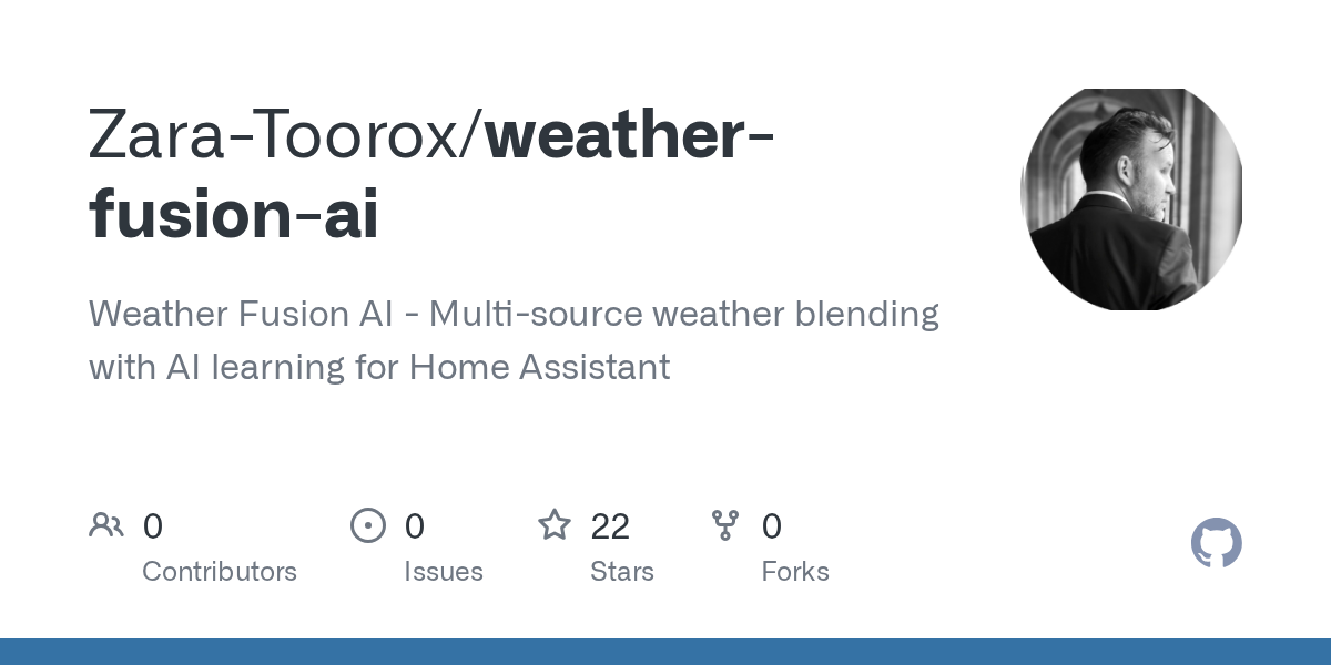

As weater source I use that integration:
Yes thats a valuable point with the chimney :slight_smile: I considder it.
The weather-fusion-ai integration looks interesting, but since it’s protected by pyarmor I can’t inspect what data it actually exposes — horizon, resolution, which sources etc. are all opaque.
My open-meteo integration provides cloud cover (%) and a full 7-day hourly forecast, which the model uses directly for next-day predictions. Either way, the Weather Plan Today sensor exposes both primary_evaluation and secondary_evaluation attributes, so you’d be able to compare how well any weather source actually performs against real consumption — a concrete way to validate whether the AI blending adds value over a standard forecast.
I use it because at my House the temperature is often up much lower as the forecasted one.
Right now Open Meteo 7°C
Reality 2,4°C
Weater Fusion AI 5,2°C.
Hope it will get better with more training.
