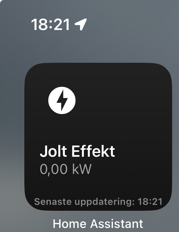

UPDATE: I had to check it out. You just create a widget on screen then click on it, and you can create your own. I might depend if you want to fit more than one sensor value
I have the same issue, now I created my first customized widget but I can not find it anywhere to edit it or add a new one. If you add a new widget it now takes automatically the last created one.
I have the same issue. I looked through all the settings but couldn’t find an option for this.
