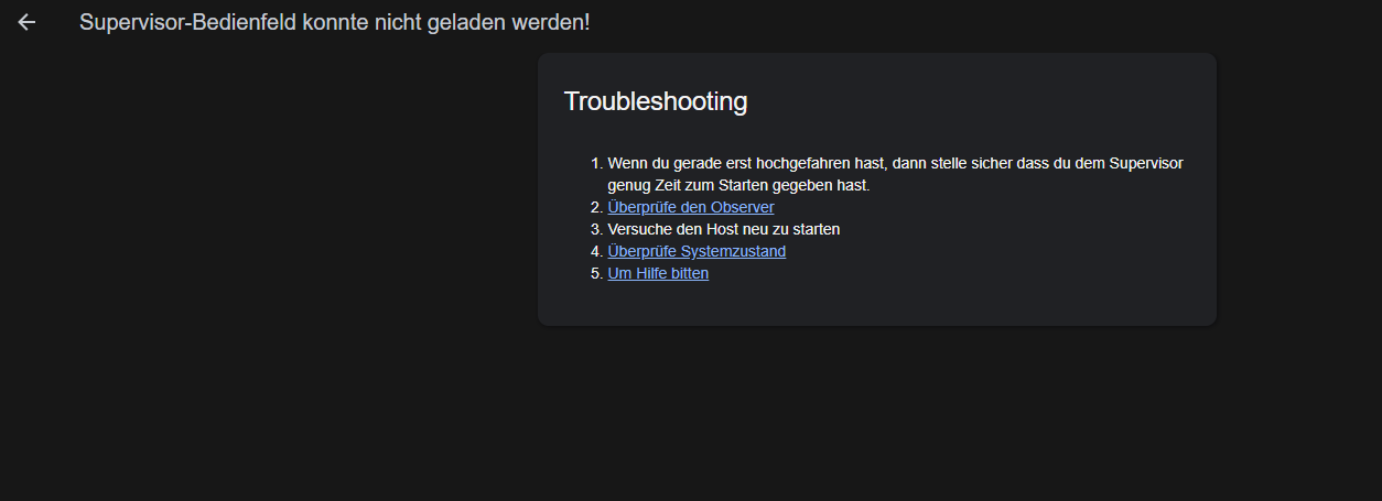

After upgrading to 2021.11 (Hassio) - Supervisor tab does not load for me
I get a screen with:
Troubleshooting
If you just started, make sure you have given the Supervisor enough time to start.
Check the Observer
Try a reboot of the host
Check System Health
Ask for help
Observer - shows all positive signs
System Health - showing āerror unknownā
the logs are full of [homeassistant.components.hassio.handler] /<<>> return code 403
for example (but much more):
2021-11-04 17:23:16 ERROR (MainThread) [homeassistant.components.hassio.handler] /homeassistant/options return code 403
2021-11-04 17:23:16 ERROR (MainThread) [homeassistant.components.hassio.handler] /supervisor/options return code 403
2021-11-04 17:23:16 ERROR (MainThread) [homeassistant.components.hassio.handler] /info return code 403
2021-11-04 17:23:16 ERROR (MainThread) [homeassistant.components.hassio.handler] /ingress/panels return code 403
2021-11-04 17:23:16 ERROR (MainThread) [homeassistant.components.hassio.addon_panel] Can't read panel info:
2021-11-04 17:23:16 ERROR (MainThread) [homeassistant.config_entries] Error setting up entry Supervisor for hassio
File "/usr/src/homeassistant/homeassistant/config_entries.py", line 304, in async_setup
result = await component.async_setup_entry(hass, self) # type: ignore
File "/usr/src/homeassistant/homeassistant/components/hassio/__init__.py", line 623, in async_setup_entry
coordinator = HassioDataUpdateCoordinator(hass, entry, dev_reg)
File "/usr/src/homeassistant/homeassistant/components/hassio/__init__.py", line 702, in __init__
self.is_hass_os = "hassos" in get_info(self.hass)
TypeError: argument of type 'NoneType' is not iterable
How do I diagnose and work it back to normal ?

smartandy
(Andy)
December 19, 2023, 12:54am
11
The issue is with the hassio_observer having a stale/incorrect supervisor_token. You can validate this from the hassio cli, with the following:
# docker logs -n 20 hassio_observer
[timestamp] Supervisor API call failed with error Supervisor API call failed with status code 403
ā¦
This confirms the token is incorrect. To find the correct token, the easiest way I found is look at the hassio_cliās docker inspect:
> docker inspect hassio_cli | grep -i supervisior_token
Take the new token and update the hassio_observer containerās value, by running:
> docker stop hassio_observer
> ha observer update --api-token {from_above}
> docker start hassio_observer
Verify the observer started (or run docker start hassio_observer) and it should now be working
