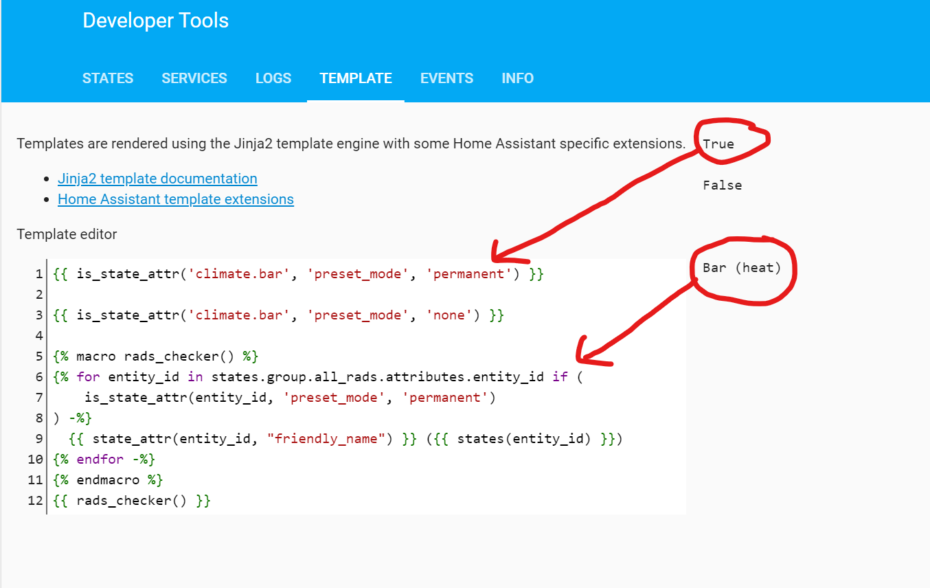

hey all,
trying to create a automation that would notify me if any of my rads is to be permanently on.
i have 12 different rads, so didnt want to create a new alert for each one!
the status for the rad is set to an attribute.
my value_template when i test in the UI works (see image)
however i dont get any alerts with my automation? is this because my value_template doesnt return a true/false value maybe?

    value_template: &rad_setto_permanent >
      {% macro rads_checker() %}
      {% for entity_id in states.group.all_rads.attributes.entity_id if (
          is_state_attr(entity_id, 'preset_mode', 'permanent')
        {{ state_attr(entity_id, "friendly_name") }} ({{ states(entity_id) }})
      {% endfor -%}
      {% endmacro %}
      {{ rads_checker() }}

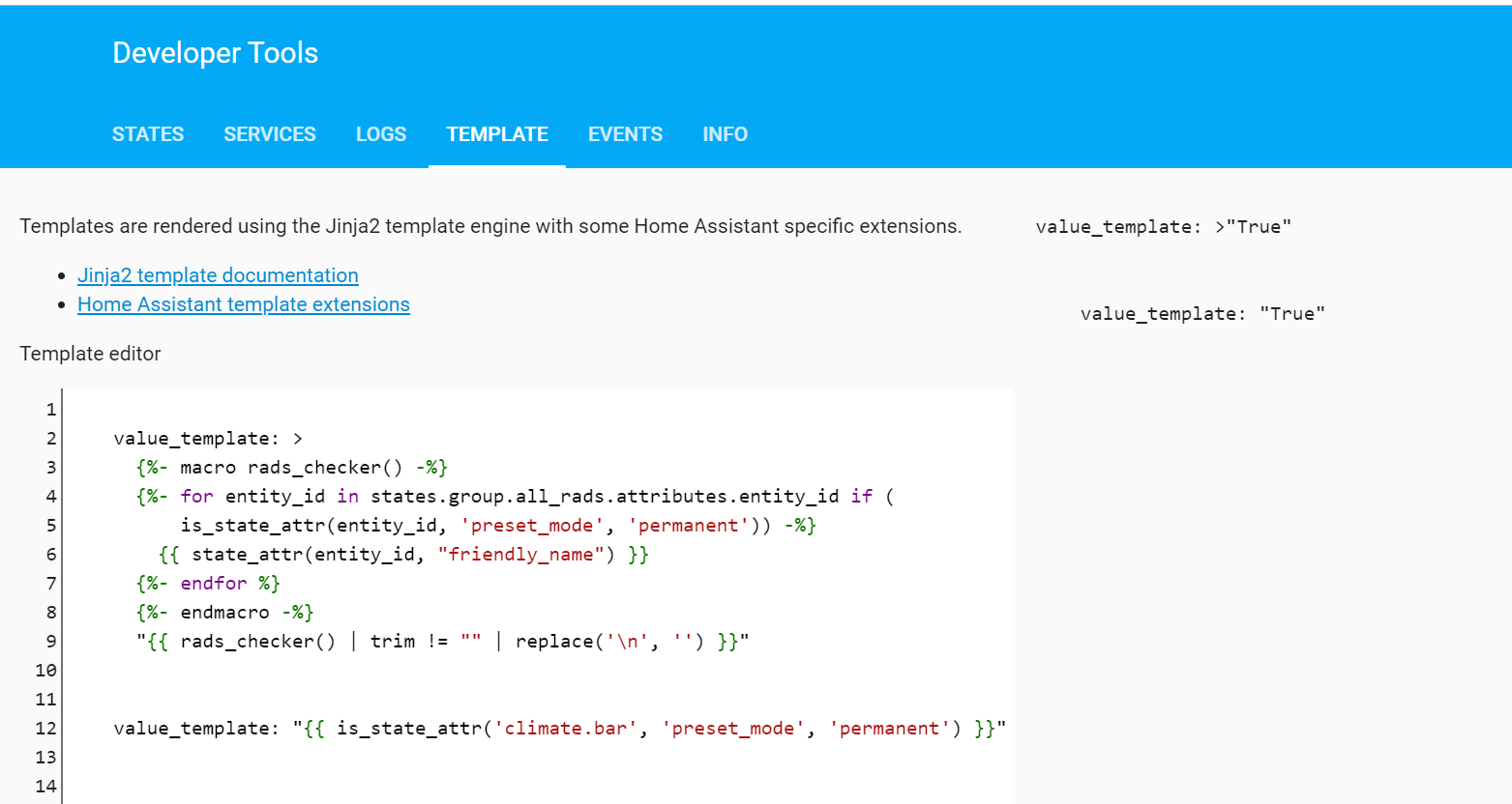

thanks for the replies. im slightly confused.
in these 2 examples below, which BOTH produce the result “true” - the 2nd one fires (works) the 1st one doesnt.
doesnt work but the value_template gives the same result
- alias: 'ALERT: Rad set to always on'
  trigger:
  - platform: template
    value_template: >
      {%- macro rads_checker() -%}
      {%- for entity_id in states.group.all_rads.attributes.entity_id if (
          is_state_attr(entity_id, 'preset_mode', 'permanent')) -%}
      {%- endfor %}
      {%- endmacro -%}
      "{{ rads_checker() | trim != "" | replace('\n', '') }}"

works
- alias: 'ALERT: Rad set to always on2'
  trigger:
    value_template: "{{ is_state_attr('climate.bar', 'preset_mode', 'permanent') }}"
  action:
  - service: persistent_notification.create
    data_template:
      message: test3
      title: Rad is permanently on3!
  - service: notify.notify
    data_template:
      message: test3 #'{{ trigger.from_state.attributes.friendly_name }} is set to be permentatly on!'
Second one has an identifiable entity that Home Assistant can listen for state-changes.
ok, i need to read up more then to understand this, will stop playing with it.
