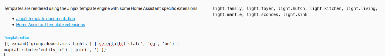

With the template you wrote you’re getting a list of State Objects. (The expand function returns a list of State Objects, not entity_id’s.) Try:
{{ expand('group.all_window_sensors') | selectattr('state', 'eq', 'on') | map(attribute='entity_id') | list }}
What Phil said; the template as shown produces State objects, not entity_ids. In my haste to write the Feature Request, I provided an incomplete template. Sorry about that. I’ll fix the first post.
