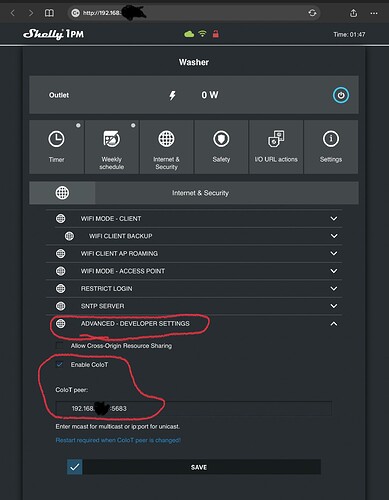

You can also try setting unicast on your Shelly device (you have to use the web interface) as described here: Shelly - Home Assistant

“Shelly devices use the CoIoT protocol to communicate with integration. For Shelly firmware 1.10.0 or newer, CoIoT must be enabled in the device settings. Navigate to the local IP address of your Shelly device”

Anyways, if this is not the case for you, then I agree with @tom_l that it’s not that hard to go to those “Advanced” setting. It’s just one setting as he mentioned.

OK. I just went back into my router and found a new IP address for the Shelly. I connected to that address on my desktop and got to a similar menu Edward put up in his earlier reply. Under the Advanced - Developer Settings, things are different. My only choice is to “Enable action execution via MQTT”. Nothing about ColoT.

My new Shelly Plus devices also don’t show this option and they still being discovered automatically by Home Assistant, so you probably is using a new device and this shouldn’t be an issue.
