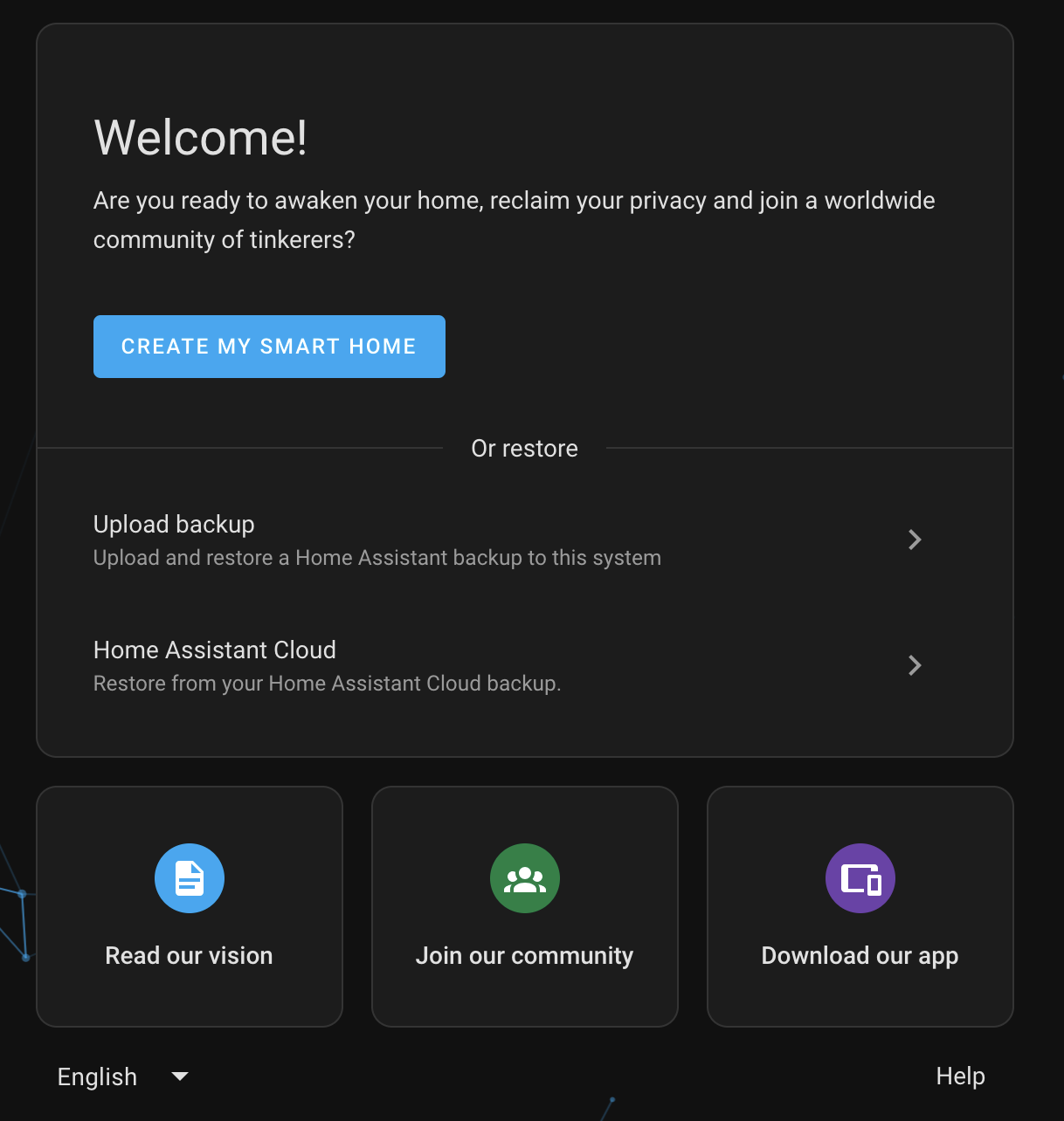

So it lost it’s IP, when I go to http://192.168.2.143:8123 I’m greeted with the dreaded…

Where’s my instance, config, work?!
Edit: Restoring from a backup now…
