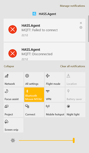

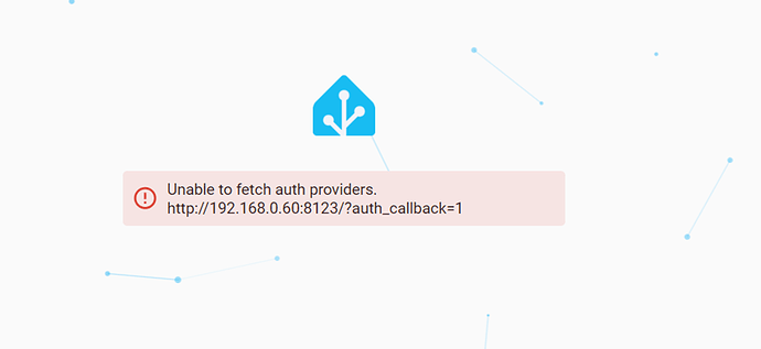

I was just going to post that my Pi4 – 2GB had updated to 16.0 successfully and had been running for a couple of hours.
However, as I was going to take a snip of the system page, a HAASS.Agent notification popped up, as shown. Then trying to log in showed the following in the Microsoft Edge Browser.
So my HA has now gone down……
Updating this, HA restarted itself after 5-10 mins.
But it is now going through the same unavailable cycle again,

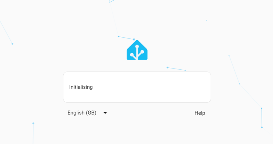

I’d be really grateful if anyone can help me! I feel like I’ve somehow missed a large chunk of this discussion and I’m still sitting here 4 days later with a dead Home Assistant and an unhappy house :frowning:
  1. I’ve been unable to connect to the HA Yellow as a terminal. Can anyone help me troubleshoot? As mentioned above, I’m using a Mac and the built-in “screen” command. I can physically attach the the HA Yellow, I can see the new USB device appear in the device list (“ls /dev/cu.*”), but as mentioned above, if I try to screen to it, I get an error to the effect that “$TERM is too long… sorry”. So I tried ‘export TERM=“vt100”’ first, and then screen seems to run but the screen is blank.
  2. Even if I can get connected… what do I do next? Do I just run “ha os update --version 15.2” or is the recommendation to try some other troubleshooting first? (As mentioned above, I REALLY don’t want to risk wiping the NVMe that this is installed on – as it contains a lot of history and my backups (something I intend to fix as soon as this issue is resolved). I’m assuming this just reverts the OS without bothering all of the files/settings/history on the volume itself, right?
  3. If I can’t manage to connect to a console, is there an approach to fix this by mounting the MVNe on a different computer?
