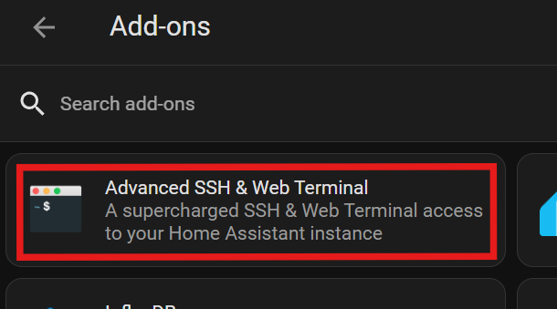

The other method of accessing the HA Yellow is via a SSH session. This requires that you’ve already installed the following HA Add-On.
If you haven’t already installed that Add-On, I am not sure there is any way for you to connect to the HA Yellow via an Ethernet connection.

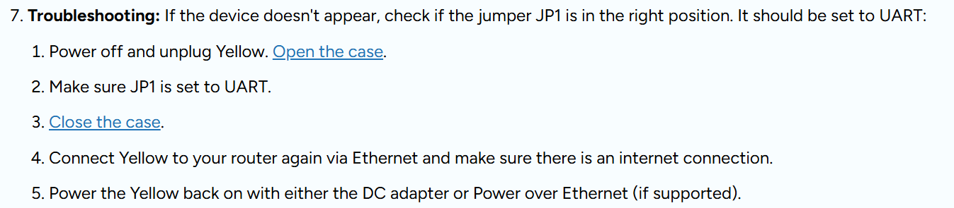

Did you move the physical JP1 jumper on the HA Yellow board to UART per the following instructions?

@ogiewon Thanks. I did confirm that the jumper was in the UART position when I tried the steps above…
