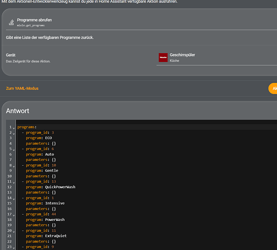

So my dishwasher has a few programs that can be selected via a service:
I now want to create a dropdown to select a program. My approach was to create an automation that runs when I select a program in the drop down.
