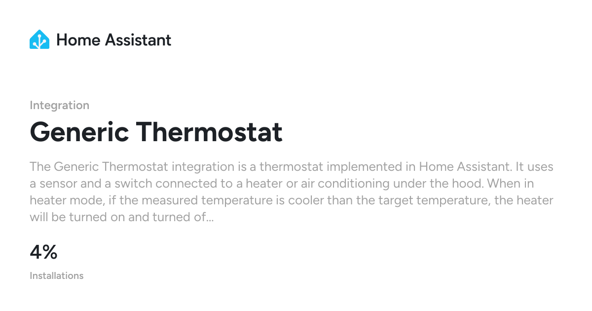

Or use the generic thermostat and switch to a preset mode at the time you want using an automation. This will allow you to adjust settings easily and manually turn off or on if needed.
