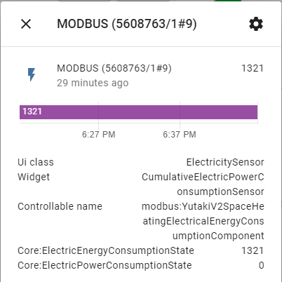

I finally installed it using the instructions on your github. Not difficult at all . I now got back two modebus sensors / entities under the Tahoma intergration which seems to be electric consumption for my space heating and the Domestic Hot Water (See Pictures) . It doesn’t give any more info about state or current temperatures of heating or Hot water . i wonder if I should do anything else to get more info from the intergration. Any way thank you again. It was a small step forward
I did sent you a private message, let’s continue there or in the Tahoma Integration Refactored - Share your Projects! / Custom Components - Home Assistant Community (home-assistant.io) topic.
I don’t want to hijack this topic.
